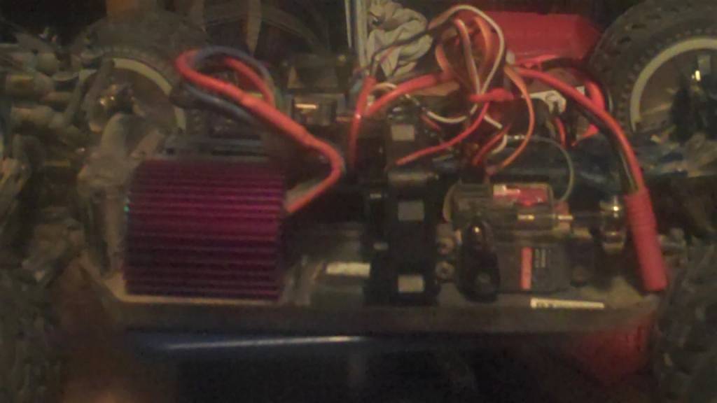

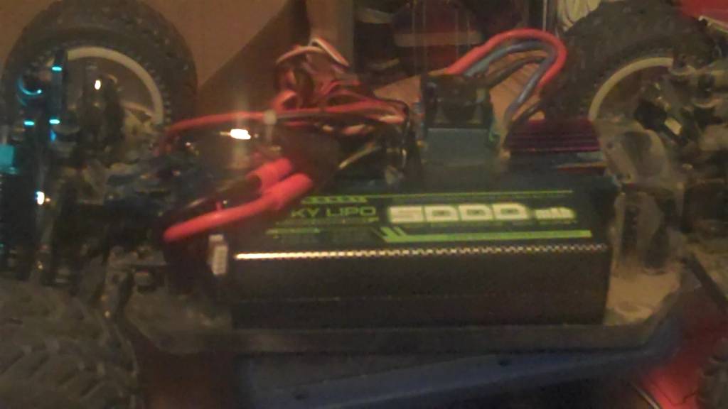

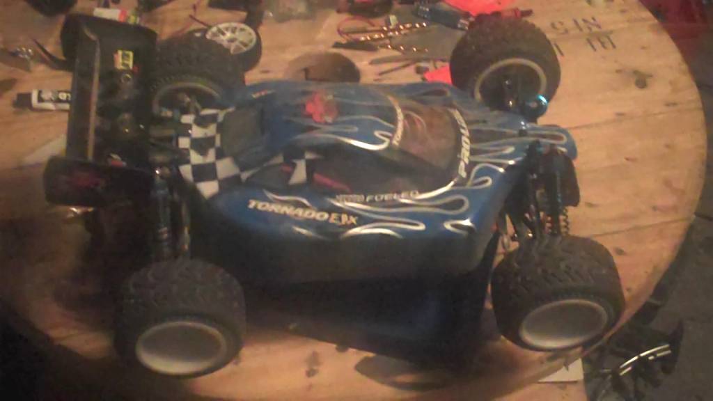

I just happen to be on the course!
Its still a work in progress, but check out my vid:
http://www.youtube.com/watch?v=xnnG09QL1rI
I added duel heat sinks and a fan off a 8E (both from redcat) to keep the heat down.
Stock gearing right now, but with taller 2.2 tires.
Running a 3s 5000mah 60c (burst) lipo battery.
I just had to buy a new pinion gear...as 3s power shredded the it!

this is tricky, cause the offset on the stock wheels is hard to match with 2.2 wheels.
Offset means that the place on the wheel where the hex sits. On the tornado, this is toward the chassis.
I used traxxas rustler 2.2 rear tires on mine. They worked perfect for the rear of the buggy, but on the front the wheels inside "ribs" rubbed against the suspension arm. I had to trim these ribs with a hobby knife.
I think I read that someone used traxxas 2.8 rear tallon wheels/tires and they fit without modification.

well, the 5000mah is the capacity (runtime) of the battery.
The 3s (3 cells) or 11.1 v and the 60c (burst current) of the battery are what up the speed. That combined with the larger tires (which increases the gearing)
The power of the novatech 540 motor is pretty good. Im fairly sure that I will reach the limits with the speed control before I hit the limits of the motor.

Best way to get more speed is with a 3s lipo. Note, you will have to change the ESC's fan to be powered off the reciever or a seperate battery. if the fan gets more than "X" voltage it will die. And without a working fan, the ESC wont handle more power.
I wired my motor fan and ESC fan to a 1000mah 2s lipo pack. But you could use a simple 4 "AA" battery holder like nitro rc's use to power their servos.
