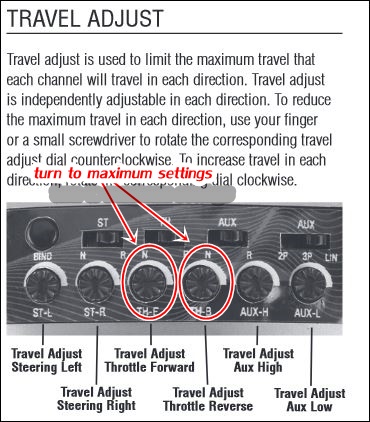

I picked up a Hobbyking 150a ESC, and I can't get it to program or set throttle limits.
the instructions say to set throttle limits first. It will not recognize the full throttle input, but will recognize if i go into reverse. This is consistent even if I reverse the channel in the transmitter.
It will beep like it initialized but I cannot get any output.
if anybody has experience or tips with this ESC I would greatly appreciate any advice. I am new to cars, but not new to RC.

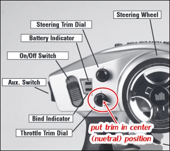

Your throttle trim is set to neutral? Is the EPA settings on the throttle channel ...set to 100% forward and reverse?
And also check the Dual Rate for throttle channel if you have one...set that to 100%
Then do a throttle range calibration again.

I see Spektrum doesn't call them EPAs sorry.
Start with these adjustments and recalibrate ESC throttle range.
If that doesn't work I check with HobbyKing
