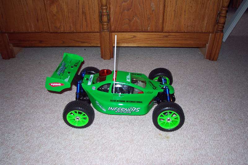

Ok, long story short: I was racing my Inferno sports buggy in my street and this stupid porshe ran it over and didn't stop. Nothing was broken but a couple engine fins were smashed. Everything else is ok and untouched. Now, my engine will not start. The compression is fine and everything is ok. The only thing I noticed was that the fuel was not getting pulled into the carb as i pulled the pull start(with thumb over carb opening) and this seems to be the only problem. Will i need a new engine? The fuel filter is clean and ok. Thanks for any advice

Make sure the case is'nt cracked, thats what it sounds like

Sounds like the carb is damaged, or at least the high speed needle. your gas tank might have a pinhole leak also. If I were you I'd find the car, egg it, then run lol.

Well, I know that the case is not cracked beacuse Ive taked the engne apart and put it back together. The engine is perfectly ok internally, but i have not fiddled with taking the carb off. The engine is a gs-21 pullstart engine. So I am going to take the carb off rihgt now and see if there is anything wrong. Does the type of carb(if i need a new one) matter any good ones to use in my engine? should i get a new cylinder head or will performance still be the same? Should I just go with a new engine all together? Is the Os .21 rz a good choice(dont worry, ive learned from my mistake)? Thanks for your help

I'm willing to bet there's a crack in the crankcase, probably not visible to the naked eye but I'm certain there's one somewhere and the carb is another possible issue.

Well, I took the carburator apart totally and put it back together with lube n stuff, and still, there is no suction. I think id wrather get a new engine beacuse i will be sure it will run. I dont even know the source of the problem. Engine suggestions?? os .21 rz is the engine im focusing on or a nova rossi. Im probably going to get one off ebay beacuse of the huge price difference. Thanks!!

Slayer........it sounds like to me , there is a slight air leak , and i bet i know where it's at. I had the same thing happen to my engine , but it was from losing control and slamming it into a fire hydrant at about 35MPH!! What had happened was right where the carb attaches to the block , (where the stem for the high speed needle is) , there was a super small seperation between the brass fitting and the casting of the actuall block of the motor. I took the motor off the buggy , took the pipe off , put a little fuel in the carb and turned over by hand. I then blocked both the exaust and the intake with my finger's and tried to turn the motor over. What i saw was some really small little air bubble coming from that seperation. I took the motor ( RB C4) to the hobby shop and got a new carb ordered for it.
the Carb it'self wasn't damaged , but the stem for the high speed was , and i didn't want to take a chance and try to rig another one back onto that carb just in case. After i got the new carb..........she fired right up!! Well............hope that gives you another option , instead of going out and buying a whole new motor.

Well, I found the leak, i dried the carb and put some fuel; sure enough, soon fuel slowly leaked at thehigh speed needle(where it attaches to the carb. Thanks for your help and now i can use this engine until i want a new one. Do you know any good carbs for my engine and the price? thanx!! Pics soon!!
