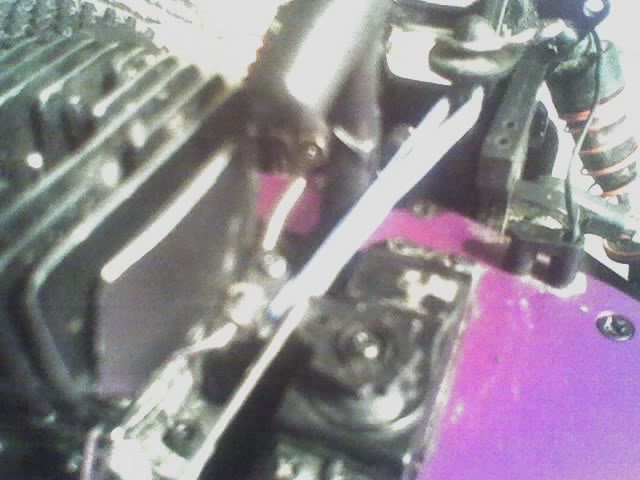

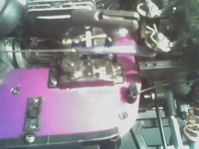

i made myself a fail safe out of rubberbands. when i loose signal the rubber bands pull my servo to brake, and it dosent seem to affect the preformance otherwise. i tested it by giving the car full throttle "without the motor running" and then shutting off the transmitter. it returned to brake. the rubberbands go from the servo horn to the rear body mount. tell me what you think.
Old 01-28-2007 | 08:28 PM
  #2181
TrailBlazer250's Avatar
Joined: Dec 2006
Posts: 499
From: Garden Grove, CA
Default RE: official smartech buggy thread
excuse the picture quality "camera phone"[img][/img]
