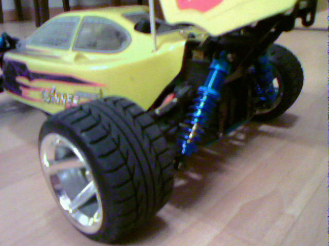

yeah smartech shocks sucks. mine started leaking oil after a few days.. so that soon became the first upgrade. got me some AL shocks along with a ball bearing upgrade kit from rc-mart, works perfect and handles a lot better.

yeah...i would put some copper or something like that on the rear shocks....but im just going to get some better shocks and springs...the front work fine...just the rear sucks...im also trying to find some good rechargeable batteries to put in it...just hard to find a good pack that will fit in the tiny battery compartment..any suggestions?

codykrr: these are good shocks and they came with two different types of springs and they are fully adjustable. I used 80 mm rear and 70 mm front, 60mm will also be suitable for the front.
