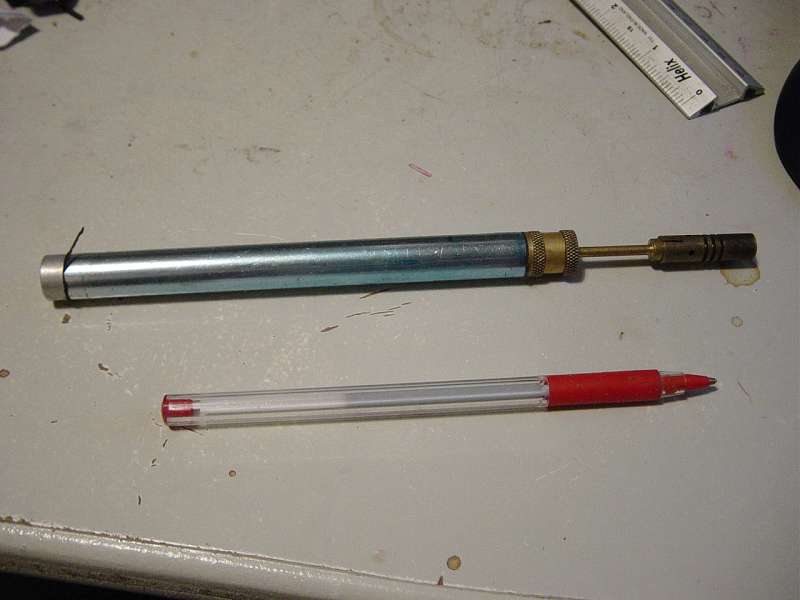

i personally always use the red loctite, tho i dont recomend it if ur not used to using it. sometimes it catches me out tho... so i use a gas torch pen that runs on cigarette lighter gas, its very good for getting a lot of heat into a small area - 10 seconds or so of this little fella soon convinces the threadlock to let go.

sometimes even heat from my little gas torch isnt enough and the head still snaps off - then i use a dremmel to cut as deep a groove into the screw as possible, thru its centre, heat it again, and try to get it out with a flat headed screwdriver. this normally works, but u end up with a cut in the surrounding area around the screw, and sometimes even this doesnt work and u end up having to drill and retap the hole...
