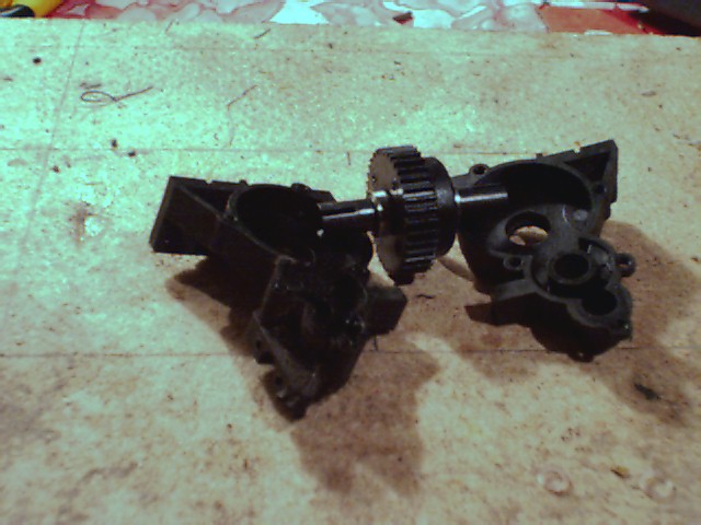

Tighten the nut on the spur gear, and make sure the clutch and spur gear are meshing properly. Then while you are at it, you should back out the screws that hold the recoil start on and add loc-tite and retighten. Same goes for the head bolts!!
Men, the picture appear be my car, and believe, i did that.

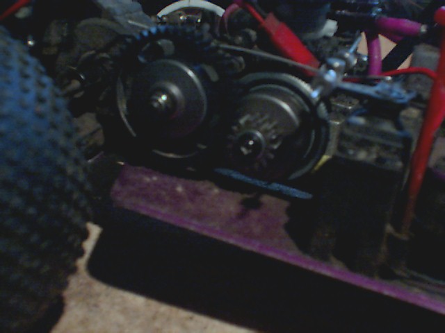

Default The car do not run
So it's still not going? Maybe it's in your diff? I took mine apart to put in the bearing upgrades. It's not too bad to tear down and check your gears in there. Also check the c-clip on the opposite side of the spur gear. It goes thru the case and is fastened on the other side. Careful, it seems to me that the c-clip is kind of an odd-ball size, and tough to find outside of a hobby shop.
Could be that if his engine is coming up to speed and not engaging the clutch that his clutch shoes are shot. You should check to see if the clutch bell is spinning!
