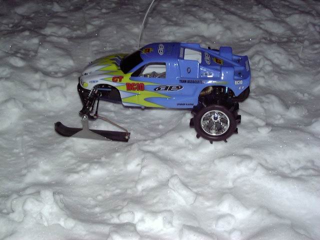

Snow is a blast. I put sand paw tires and ski's on an RC10GT. Check it out.http://www.island-designs.com/pictur...RC10GTSKI2.JPG
We run in the snow lots (10 months of winter ) and have experimented with skis. With the skis on the trucks they didn't steer well at all on hard pack. On softer snow the skis worked better but now the rear tires would just sink or spin down. We ended up going back to front tires which worked much better since the truck will only go on hard packed snow anyway. It was a great winter project though. Wait a minute, maybe tracks on the back, I wonder.

I am still in the experimental stage on snow. I have run with the directionals and it is fun. My first set of ski's were narrow and they steered incredible. Problem was they would not lift over any of the deeper snow. This wider set does not steer as well but if you are up to speed the truck stays up and fast through the snow. Tonight I added some strakes or runners on the edges of the ski's. I will give it another run tomarrow. It was too #*@! cold to stay out for more than 15 min with out gloves today 7°. I have an O.S.CVRX on this truck with an 18 tooth clutch and a 62 tooth spur gear. This thing flies across the snow.
