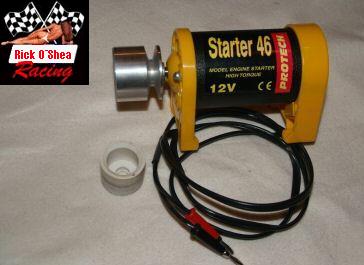

Old 05-03-2007 | 04:28 PM
rickburnout666's Avatar
Joined: Sep 2006
Posts: 794
From: The compost heap of theKent, UNITED KINGDOM
Default RE: Bump starter problems, please help
I use a homemade starter box with a airplane starter and 12 volt battery, it turns over the .39 engine i have fitted in the car i`m building, my friends starter runs with 2 7.2 volt nicads and a 540 motor and it just smokes and cant even move the engine.
