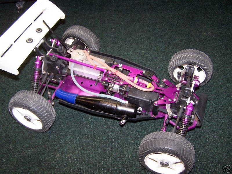

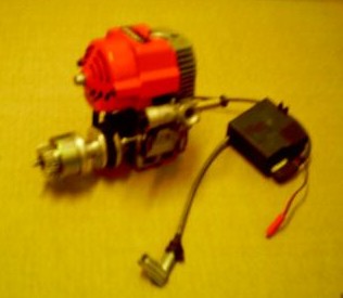

I have an old Mugan Athlete buggy which is in great shape, almost never run and a Compagnucci .39 petrol engine which I would like to combine to make a fun only buggy for use on short grass and maybe concrete.
I have changed the wheels for a set from a Hellfire truggy, these have a larger diameter and width.
I have so far stripped the existing Athlete into bits and am playing with how to get suitable gearing to give a reasonable top speed and good acceleration.

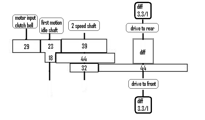

I would like to retain the central differential and add a two speed transmission to make the most of the new engines limited RPM and power.
I have bought a savage 2 speed gearbox that wont fit in its present form, but having stripped it and played around with different configurations using the gears within I have come up with what I think is a possible gear ratio.
I will dispense with the gearbox case and support the bearings at either ends of the gear shafts using 2 fairly simple to machine alloy plates.
I wish to include a pull start and have obtained a suitable one which will fit directly onto the nose of the crankshaft or the first motion shaft in the gearbox. The compagnucci clutch bell has a one way bearing in it to enable push starting the car, but the one way bearing in the two speed box make that impossible! Also the pinion on the bell is very soft aluminium and to small so I will change it for the old output pinion in the savage box which improves the gear ratio.

To be honest I am totally lost with the gear ratio and estimating performance, so far I have come up with this….
The existing mugan had a gear ratio that assuming 30,000 rpm would equate to a top speed of 35 MPH
The gear configuration I have come up with for the new set up by my calculations equate to a top speed in 1st gear of 31 MPH and in 2nd gear of 44.4 MPH My calcs are as follows, I have divided the drive gear into the driven gear to get the ratios…
1st 0.79 X 2.44 = 1.94 X 1.38 = 2.66 X 3.3 = 8.78 engine turns to 1 wheel turn
43cm / 8.78 = 4.9 cm/rev 4.9 X 17000 X 60 = 4998000 cm per hour = 31 MPH
2nd 0.79 X 1.7 = 1.35 X 1.38 = 1.85 X 3.3 = 6.11 rpm x 43cm X 17000 / 6.11 X 60 =
43cm / 6.11= 7 cm/rev 7 X 17000 X 60 = 7140000 cm per hour = 44.4 MPH

I have done a little diagram of the gear box layout and included a pic of a Athlete buggy and the Compagnucci petrol engine, I am having issues with my digital camera, so actual pics will follow!!
Apologies for the long post, any advise would be greatly appreciated!!!
