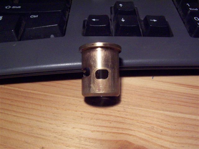

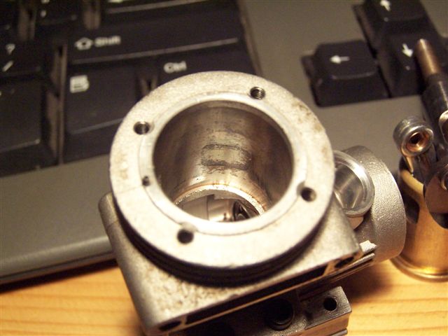

Okay, finally some pictures. The first three are of the bare sleeve, obviously, and are pretty self explanitory.

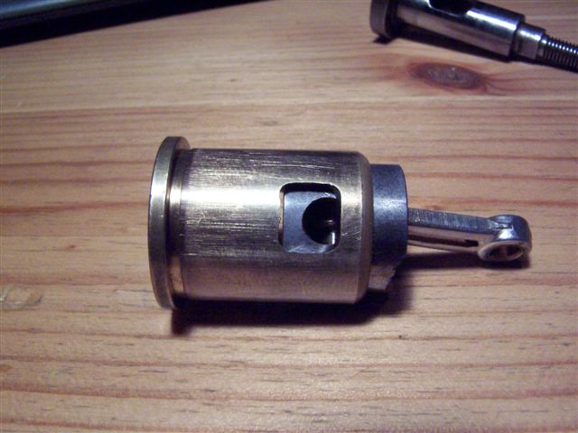

The next four show the piston at BDC. The first two are of the boost port: you'll see in a later photo that there is no channel in the crankcase around this area, so the boost port is fed by that little hole in the piston - air/fuel comes out that hole and into the port, where it travels up and past the piston, into the cylinder. The next picture shows the poor alignment of the piston and the transfer ports - yes, the piston is at BDC! Also shown is the exhaust port again.
The next set of pictures shows the engine reassembled and with the piston at BDC - first picture is the boost port and the last picture is the exhaust and rear transfer port.

The first two show a fairly boring crankshaft. The center hole elbow is actually pretty good, in that the back side is nicely radiused and the entry isn't as bad as some other engines I've seen pictures of (cough)Traxxas(cough)
Finally are some pictures of the crankcase, mostly showing areas where the machining could be "finished" a bit nicer. There's a ridge at the bottom of the bore for the sleeve that can impede airflow with the piston at BDC, and there's a chunk of metal at the bottom of the front transfer port, but it is probably not too badly in the way.
For improvements I see a few areas that are going to be fairly easy and could be effective: I will open up the hole in the piston to match the width of the boost port and I will shape the bottom of the boost port to allow upward airflow. I will radius the inside edge of the piston hole a little bit too. I will remove the ridge at the bottom of the bore in areas where it will help (pretty much only around the front transfer channel) and I will remove other casting flash while I'm at it. Since the bearings must be removed for this operation, I'll probably get me a sealed front bearing to gain a bit of lower chamber compression. I will consider opening up the ports a little and changing the timing to something approaching some hotter engines (copying timing numbers, basically), getting the boost and transfer port timing to around 120/125* and bringing the exhaust port timing to closer to 165-170*. I will radius the edge of the crank bore inlet a little and I MIGHT try some turbo scoops, but I'm not sure if I should open up the crank timing to closer to 200* or not.

Definitely, open the crank induction timing to at least 200degrees if you want to increase your lateral intakes to 120-125degrees and your exhast duration to 165-170 degrees. With some simple trig, you can calculate just how much to cut left, right, or both to increase the total duration even before you put the Dremel to it. To verify your work and se whether you achieved you target induction pofile, use your degree wheel of course.
Since your engine is a side exhaust, seriously consider reshaping your lateral intake ports to direct the fuel-air charge away from the exhaust port. (These lateral sleeve intake ports are not "lateral" in relation to the centerline of your engin, in reality, they are posterior and anterior to your engine centerline.) Camfering the ports to direct the fluid flow up and away from the exhaust port is a start, and camfering the upper part of the ports will also increase their duratrion to your target profile. Additionally, you will have to reshape the block passages to also help the Schnuerle effect of the loop scavaneging and directeing the fresh fuel-air charge away from your exhaust port. Not an easy thing to do in a side exhaust engine.
As for your xhaust port, the shape of the side exhaust port is as you put it in the engine forum, quiant. Actually, it is seriously inefficient. I do not know the dimnsions of that side port nor how much material you have to play with, but to help with exhaust flow out this port, the best you might be able to do is reshape it in a flattened diamond shape or a flattened pentagram shape. You will have to similarly mod your pile manifold so that the modified exhaust "slit" now matches your engine's exhaust.
Post your your progress in the engine forum too, though we mostly mod rear exhasust engines, many of us are intrested in how one would mod a "quaint" port configuration and port shapes to improve output. Also, aside from letting us know what timing profiles you achieved, let us know what your new port areas are in relation to what ther were before you started.

Ed - yeah, I'll be updating the thread as I make progress. I'll put it back together dead stock and make "before" videos, so that the "after" videos have a little meaning. Hopefully.
Jim - The port areas are going to be tough to calculate properly because as you see, the bottom of the piston actually defines the bottom of the port. I can give the width and I can measure the piston travel before the port is covered, and that should be sufficient.
Sadly in this design there is no "short side radius" to be had - obviously I can't modify the piston, though that would definitely increase flow it would also kill the pinch.
I believe the defining limitation to the boost port is going to be the hole in the piston and how much meat I want to remove from that. The one side of the hole encroaches into the pin boss area, so carving away at that willy-nilly can weaken the piston significantly. We'll see what happens.
The transfer ports have a slight bevel to the edges, pointing the flow towards the boost port, but yes I intend to widen the transfer port towards the boost port and modify the flow channel in the case to suit.
One thing I noticed after I posted the pictures is the burn pattern on the top of the piston: at the edge of the piston right near the exhaust port there is a moderate brown stain that is also faintly showing in the middle of the piston, but on the sides where the three intake ports are the piston is clean. It's pretty clear where the fuel is washing the piston down... In the full-size engine world, one would read this to mean that you've got fuel separation at these clean areas and the burn is all happening near the dark areas, and you'd start reshaping the combustion chamber to try to eliminate flow separation. Clearly there's nothing to be done about it in this engine.
Oh, and I should also mention: this engine has about .010" squish clearance, but I haven't looked closely at the button to see what it's shaped like. I know the center is hemispherical but I don't know if there's a conical or spherical shape to the squish band. The piston is dead flat.

As promised, here are the stock port dimensions:
-Boost port is .308" wide, and .084" is open between the piston at BDC and the top inside edge of the port. Of course since the top of the port is beveled towards the cylinder, the area is hard to measure otherwise.
-Transfer ports are .250" wide, and .103" is open between piston at BDC and top of the port. Width is estimated (+/- .005" ) at the entry to the port, again because the side walls of the port are angled towards the boost port.
-Exhaust port is .440" wide at the inside edge and .170" between piston and top of the port. Impossible at this time to measure the sleeve/case mismatch, but I'd estimate it at .010".
-Crank port is .275" wide by .415" at the longest point.
-Piston hole is .215" in diameter. Clearly this can be increased to match the .308" wide boost port, even if the boost port width is left alone.
