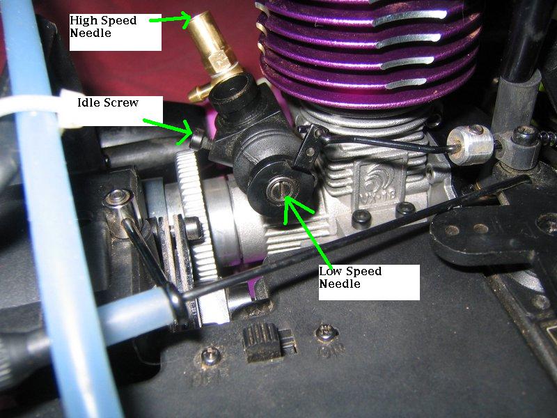

I have some problems with my Syclone Pro i cannot find the needle for low speed, the screw that it have only hold the carburator thats its connected to the servo, and if I move that screw nothing happend,
that the Syclone PRo have that needle? or only have the high speed neddle?
thanks

if i'm not mistaken you haven't lost the needle you just don't know where it is? The low speed needle is located where the throttle linkage connects to the cab, if you look on the side of the throttle linkage arm on the carb you will see a straight end screw head, that's the low speed needle it should be pretty much flush with the carb arm housing.

ORIGINAL: decompetencia
thanks
here you go brother

Opps, there ya go, a picture is worth a thousand words, lol. thanks

Hello guys it me again, finally i found a picture pof my engine, and there is not low speed needle, what can i do? how can i tunned, or where is that low speed needle, thanks

if thats the engine, you dont have a low needle, you just adjust the hight needle, not all engines have the low speed needle.

So that means that I have to tunned only with the 2 needles that i have?, how can I do that?, I am openning the high speed needle at 3 clock, and what else?, what can I do for low speed?, thanks

dont worry about the low speed, just open the high speed 3 full turns counterclockwise from closed and that should be a good starting point.
