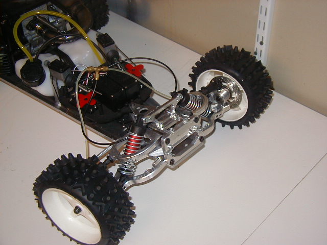

Here are some shots of my FG Modellsport 1/6th scale buggy. Its a Marauder, but im converting it to a Mitsubishi Pajero. I changed out almost every piece of plastic to aluminum. hydraulic disk brakes on all 4 wheels, 2 speed gear box, 26 bore kit for the zenoah engine, adjustable slip diff , etc ...
i still have to change the shocks out for adjustable ones, and finishe the radio component set up ... (2 1/4 scale 170 oz servos for steering, and 2 more servos for throttle amd brake master cylinders ....

back side ..

wow....hydralic disc brakes,I thought I was cool cause I have em on a mountain bike but thats really impressive.did you make that?If not,who did?

check out www.fg-america.com or www.netshop.nl for 1/5 and 1/6 scale cars.
FG-America has a full color online catalog available, but i always buy from www.netshop.nl , they are way better with service, faster in shipping, and always have all parts in inventory ..
the disk brakes come in a special kit (about $450 for a set of 2, either front or back )
My futaba radio has an ABS function which pulses the brake srvo, it works awesome on the hydraulic brakes ! i have the same st up on my on road 1/5 scale car ...

You should be careful about using the abs feature. Don't set the pulse rate too high or you will reduce the life expectancy of your brake servos.
Think of the controller board in the servo like an ESC (which it is btw), constant forward/reverse slams generates heat and current spikes in both the motor and ESC (which causes the damage).
You can use the ABS feature without servo damage if you take the time to set the delay, pulse rate, and pulse sweep (servo travel per pulse cycle).
I am running hydraulic brakes on my FG EVO (1/5 scale sedan) in conjuction with the ABS feature on my KO Mars radio. Use a delay in excess of a half second (so it doesn't pulse during momentary braking). The pulse rate shouldn't be any faster than 2-3 times per second. The servo travel per pulse should be minimized so it goes from drag brake to the point of the brakes locking up.

thats good info, i have my 1/5 Evo set up that way ... im not sure how i will set the ABS on the buggy (if at all) as I think i will want it locking up for some fun drifting action ) im actually thinking os setting up the rear brakes and a 3rd channel, so i can just lock the back when i want to (rally racing style drifts , and still brake with front and back durring regular braking, i have to figure out how i will be doing this ...
im also concidering using a heading hold gyro (from one of my rc helis) for the stearing on both my 1/5 scale cars .... that way the car auto corrects and oversteer, and automatically performs perfect drifts on turns. I have experimented with this on my 1/8 kanai 2, and it works awesome. I can throw the car into a driftin turn, let go if the wheel when its pointing where i want it , and the gyro keeps the car on that heading, or brings it back to it if it over steers/skids over ...
