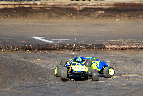

Clay, IMO provides the best surface to race on. But it requires moisture so it's best suited for indoor use. Outdoors, in the sun, clay will bake if it gets dry. That would make it very difficult to make track changes. I should think that a good mix of clay & fill dirt will provide an optimal outdoor surface, and still allow you to easily change the layout. Check with your local parks department and find out if they use/used clay for any baseball/softball fields. But there isn't anything wrong with using what you have.
Yes, many facilities use sugar to treat a track - it helps hold the dirt together and can help starting a blue groove. Can't say I remember the ratio of water to sugar - you might try calling The Nitro Pit in Phoenix. They should be able to tell you (I just recently saw a photo from one of their recent track builds, there was a 100lb sack of sugar in the photo...).

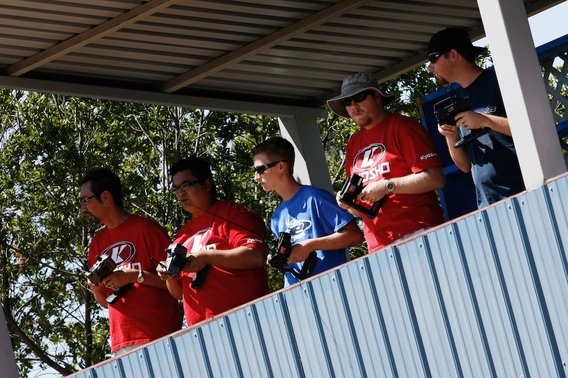

Too small a drivers stand. If you are going to have 12 person mains, make room for at least 15. Some guys are a bit over-reactive with their controllers, and some people just like to take up a lot of room. Either way, its much nicer if you aren't crowded. And put a roof on it! Shade is good!

A nice shade for the drivers stand is a must. I like Thunder Alley's (picture 6-7).
