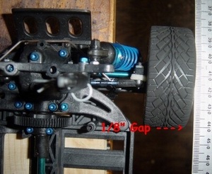

I am in the process of switching over electronics to a new (for me) Factory Team TC3 (purchased used off this site). I did not assemble this or my existing TC3, but I do have a manual to review. In setting it up I noticed the right rear wheel has "toe-in" and I can not find how to adjust it out. I don't think rear tires are supposed to have toe-in. The left rear is straight but the right is turned in almost 1/8". I have attached a picture but it's not the greatest but it may help illustrate my problem. Please let me know how to correct this.

Old 07-16-2003 | 01:46 AM
Joined: Jun 2003
Posts: 171
From: Snooplahona, NY,
Default TC3 Setup Question
Please go here....
http://www.teamassociated.com/pdf/ma...anual_2001.pdf
Goto step 2.
Look for part number 3863 with the number 4 over it. Then read the part number 4 on the same page.
And there you should have it. Its easier if you go there and read that then me explain it to you.
If you have any other problems, post it!
Old 07-16-2003 | 03:59 AM
SpoonAvenger's Avatar
Joined: Jun 2003
Posts: 172
From: Winter Park, FL
yeah the TC3 requires different parts of the piece that holds the hinge pins (dont know the name/part number) to change the rear toe in.
Old 07-16-2003 | 11:26 AM
Joined: May 2003
Posts: 67
From: Asheboro, NC,
Thanks Guys ... I missed that when I went through the manual. I guess that's just one more disadvantage to not building it yourself. But I got such a deal already built ... Anyway, glad you posted this before I tore it down. Based on what I've read now I think I will leave it as is. Need to improve my basic driving skills before I start tweeking the setup. Thanks Again.
