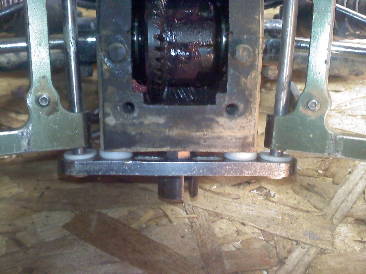

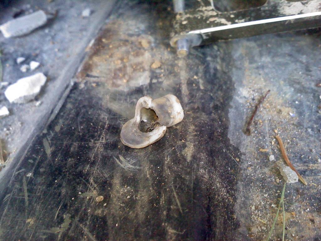

NEWRXTPROBLEM!!!
The rear pins keep poping out of the plastic holders. The pins seem to want to tear the plastic holder and streach it. Thus leaving the pin that holds the lower rear a-arm pull out. Anyone have any suggestions, or know of any better ways to assemble the rear arms?

Old 06-01-2010 | 09:29 PM
Joined: Feb 2006
Posts: 16,490
From: howard beach, NY
Default RE: RXT track problem
is the pin loose in the arm or tight?  Is there play with the lower arm that it moves back and forth?  I have been jumping my rxt for a couple of years and never seen that or heard of it from anyone with the rxt.

Old 06-01-2010 | 10:43 PM
Joined: Dec 2009
Posts: 211
From: Altoona, PA
NOTE: This is a make shift setup for now. I have no more deep cups to install the pins into. I had to use some spacers so the lower front a-arm support could be tightened down. Will post pictures when the new pin cups arrive. I hope this will do for now.
<span style="font-size: medium"><span style="color: #ff0000">NOTE: TEMP FIX TILL I RECIEVE THE DEEPER PIN KEEPER CUPS FROM HONG KONG. NEVER RAN THE TRUGGY LIKE THIS.</span></span>

Old 06-02-2010 | 02:08 AM
Joined: Feb 2009
Posts: 768
From: St Augustine, TRINIDAD AND TOBAGO
I believe what is happening here is that all the force on impacts is being transferred to the plastic cup holders since they are the weakest point.
If you had plastic arms, they would flex a bit and absorb some of the force on impacts. I've had a similar problem running aluminum arms on another rc.
Old 06-02-2010 | 06:12 AM
Joined: Feb 2006
Posts: 16,490
there shouldnt be a space between the arm and the holder, those spacers you have on the holder should take up the slack on the arm.  Are the pins loose in the arm, do they slide in and out easily?
Old 06-02-2010 | 07:40 AM
Joined: Mar 2008
Posts: 741
From: North Canton, OH

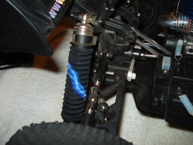

I agree Eddie - something does not look right, but I have not had a chance to look at mine. What are those white spacers and what looks like a nut between the lower arm holder and the diff case? I do not remember there being space there. I thought the lower arm holder was up against the diff case, but I could be wrong. If you look at these pics (taken from one of Adam's posts in the RXT thread), I do not see any space there. That would let the pins slip out since the plastic cups are just there to position the pins in the holder from inside to outside and adjust the suspension. They are not meant to be string enough to hold the pins. The ends of the pins are supposed to be far enough in that they are actually inside the metal.

Old 06-02-2010 | 05:14 PM
Joined: Dec 2009
Posts: 211
From: Altoona, PA
If you read my post carefully, Iexplain that I have no more deep cups left. And I had to rig the setup to accomidate the fact that I have no more deepdished cups.This is just a temp fix. Once the cups come in from Hing Kong I will post another pic of the way the arms are seated.
Old 06-02-2010 | 05:36 PM
Joined: Feb 2006
Posts: 16,490
ok but are the pins able to slide back and fourth in the arms or is it solid?  if those pins are not moving inside the arms that would or could explain why they are puncturing thru the cups.
Old 06-02-2010 | 07:32 PM
Joined: Mar 2008
Posts: 741
OK - I get it now - I missed that the first time. That explains the space. I wonder if that is stopping the ends of the pins from going in far enough to be captured by the metal lower arm holder?
How long until you get the deep cups? I have some extras if you want me to send a couple.
