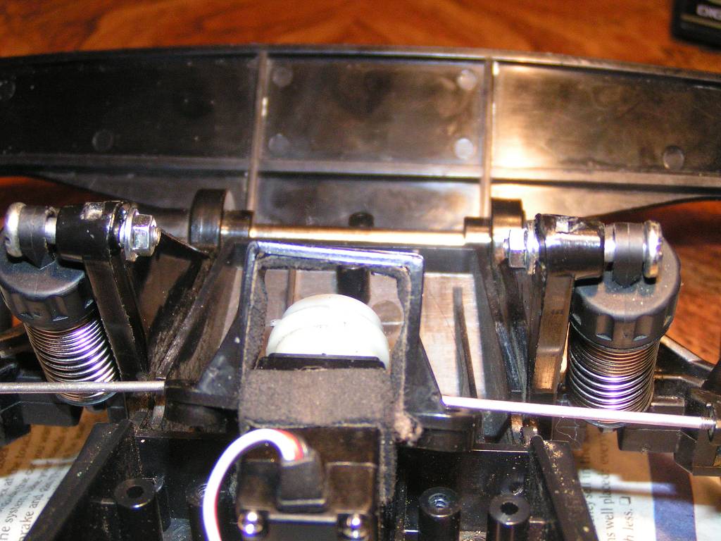

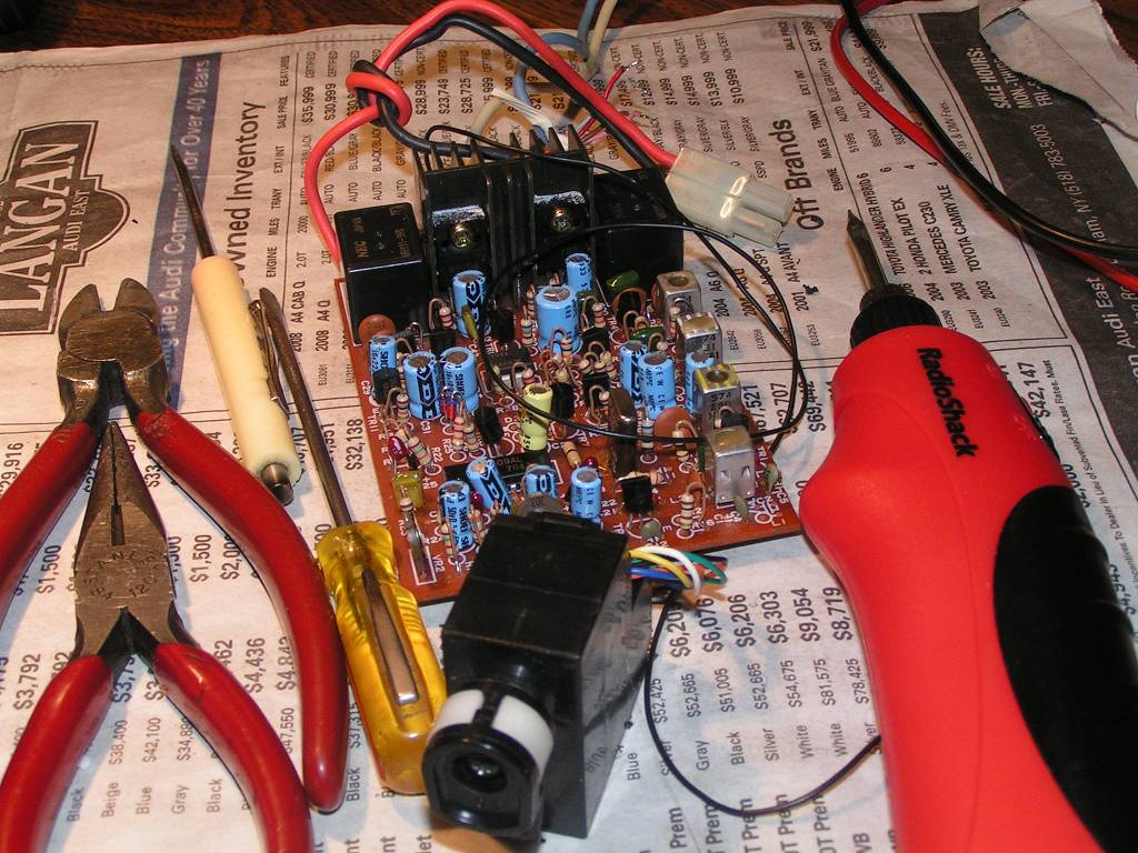

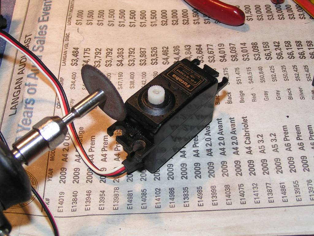

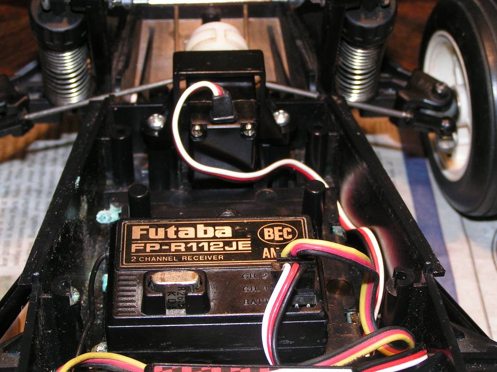

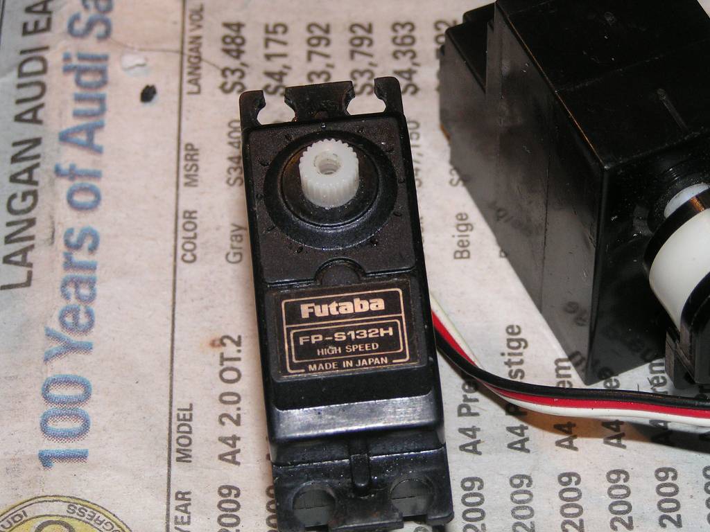

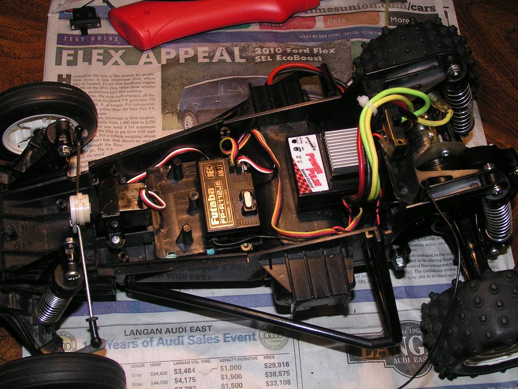

Old 02-22-2010, 10:38 PM
  #33
gulfstreamI
Join Date: Feb 2004
Location: Upstate New York, NY
Posts: 651
Default RE: Official Radio Shack Golden Arrow Thread
I got bored... So here's a few pics of the Radio Shack Golden Arrow Buggy mods I made.
Hobby grade electronics include a Futaba 27 mhz receiver with BEC, Small & compact Futaba steering servo and a good quality ESC with reverse. I got rid of the old circuit board and put in the new stuff. You will need the basic tools for the hobby plus the trusty Dremel to remove some excess plastic to fit this classic buggy with the upgrades.
ID:	1384941   Click image for larger version
ID:	1384942   Click image for larger version
ID:	1384943   Click image for larger version
ID:	1384944   Click image for larger version
ID:	1384945   Click image for larger version
ID:	1384946   Click image for larger version
