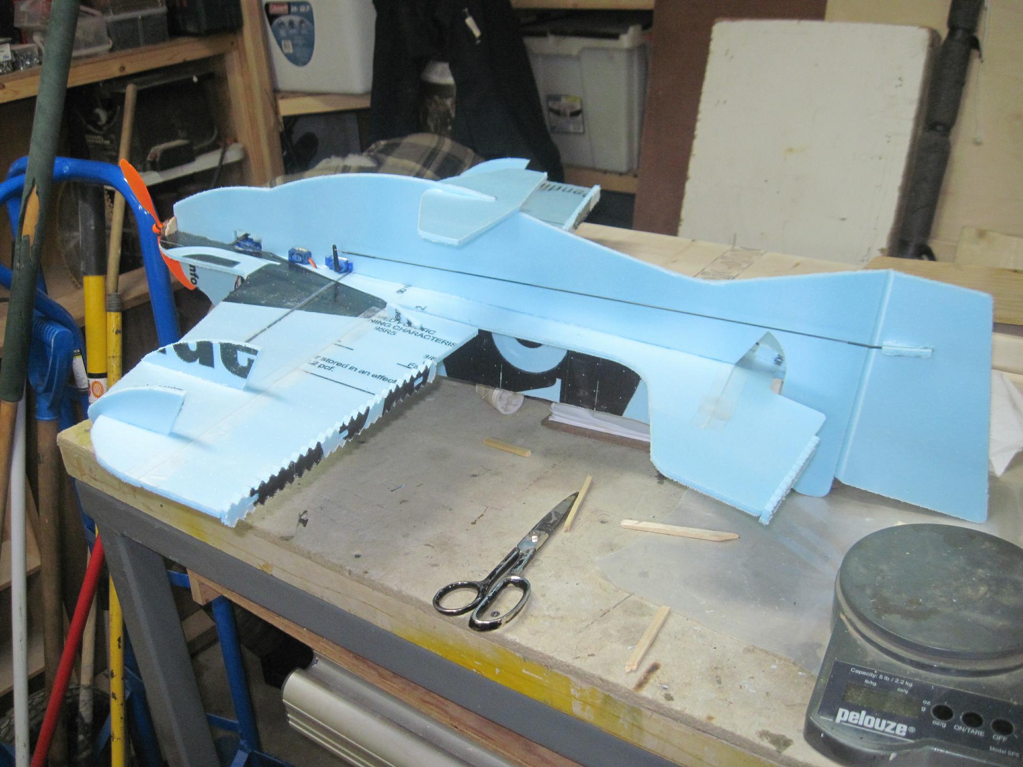

Sorry if I have been taking a bit long to answer I have been working on a new design for indoor flying. Made for cheap Hobby King parts durable enough to take a licking and keep on ticking. Its not as light as a competition machine but its made for beginners and intermediate flyers that will no doubt have some hard contact with others/walls/floors and ceilings. Its made from the fan fold foam used under siding. These fly outdoors well too. Will test fly it this Sunday.

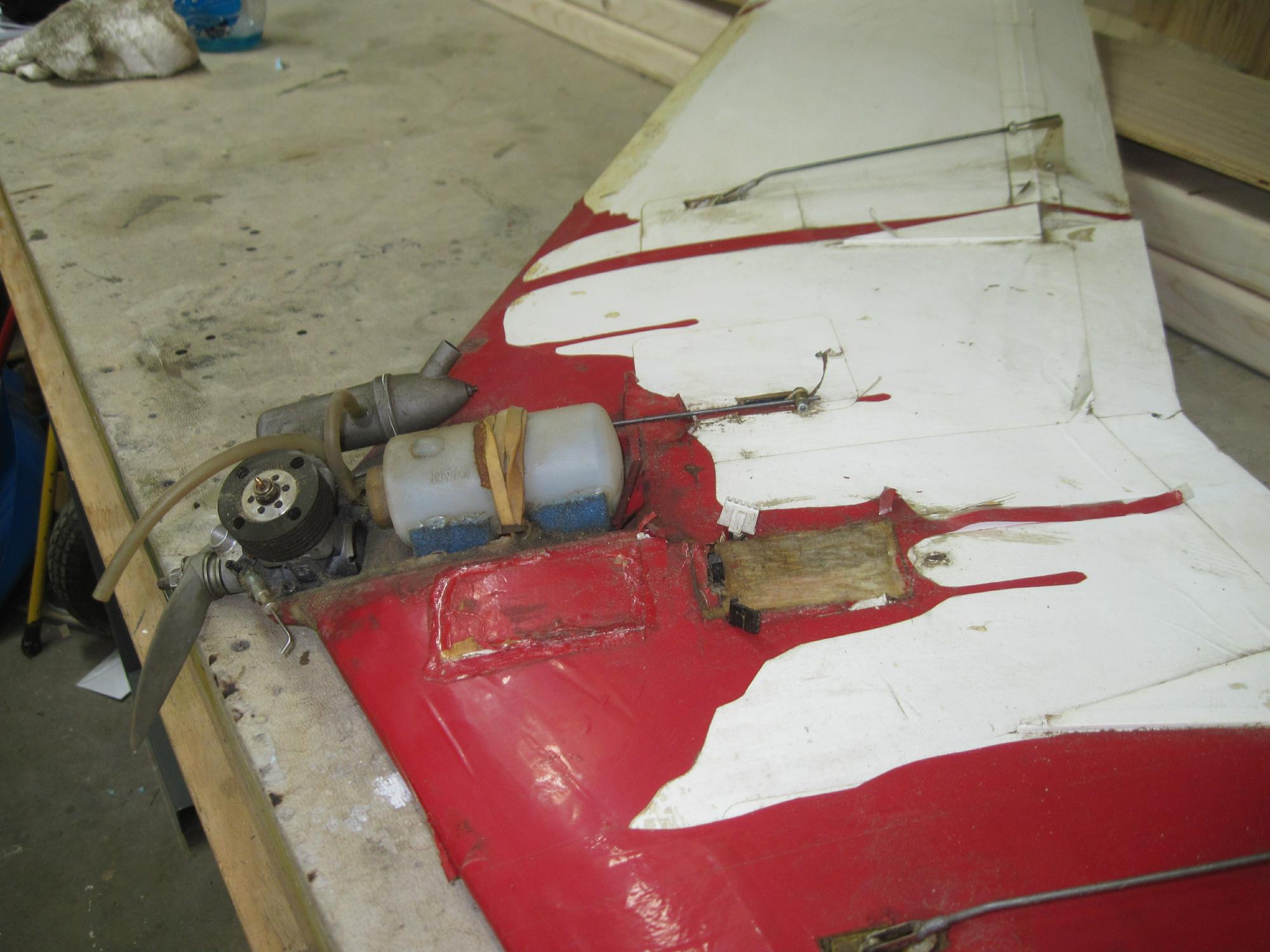

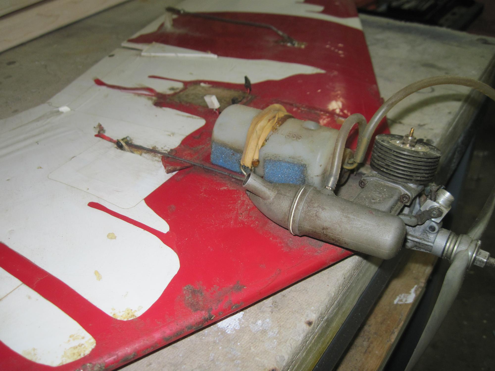

You guys are all so easy a little spray contact cement on the leading edge before each flight cleaned off with Monokote Trim Solvent to prevent build up rips streamers off better than uncoated straight wings. The tip plates got quite a few as well. Funniest strategy was to come up behind a slower flying plane and just as you crossed the ribbon hit the snap switch which was set up for extreme throw. It would do 2 or three hard snaps as it passed the ribbon often snagging it. Of course the trick was intimidation by aiming at the other plane when doing this. Mid airs were a fact of life and with a little strategic carbon fiber you could literally fly right through an opponent and as long as you didn’t hit with the motor most times you just kept on flying. Lots of foam bits floating down.
Ah a few pictures of one of the original Gremlin Killers HE HE HE HE!!!!!!!!!!!!!!!!!!!! Notice the leading edge still has old contact cement on it and the canted engine to allow the exhaust manifold to clear the wing. All electronics are inside the wing. The blood streaks are in memory of those I have mid aired with and survived. The others not so lucky HE HE HE!!!!!!

I'm digging your nitro Zaggy setup there Proworn. I'll drop you a lne Dan, thanks!

He he he designed and built long before a Zagi which was a pusher if I remember correctly. Flew a slope soaring wing called a Boomerang long before the Zagi came along. There are only so many configurations in a flying wing that work well. The Zagi like the Boomerang and the Wedgie come from a long line of proven configurations nothing new or innovative except maybe the airfoil and the amount of reflex if any.

I'm interested in how you build the engine mount into the foam wing Propworm. Can you show some detail pics?
