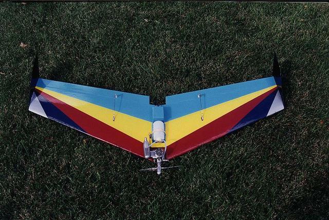

Can you cut foam cores? If so I have a simple wing that out fly's the gremlin on a .25

What is this flying wing you are suggesting is better than the Gremlin. Do you have templates? that's a good looking wing.

This is my own design when we flew combat everyone was using the Gremlin. This thing flew faster, turned harder and just out flew it period. Soon all the guys in the club were flying them and if you wanted it even more agile just lop off 4 inches on each wing panel. No need to rebalance the CofG adjusts to the new wing span. We were using Norvel .25 with an 8X4 APC and someone clocked it at over 100 mph. Somewhere I have the plans I can look it up and run you off a copy. Its a pretty rough drawing maybe even in magic marker.

Dennis, did you use tape hinges in post # 8? or was that just a mockup? http://www.spadtothebone.net/SPAD/si...torversion.htm that is another method of going with not mixing. A torque rod from the ailerons to the centre and then a horn on the elevator works. I haven't really tried it, but seen it on "For What It's Worth" a long time ago. The Spad To the Bone site has a bunch of cool stuff too. I am just making a couple right now. Saturday night Midget with a .15 should be a hoot.

The control surfaces were taped on only for the mock up of the first one to get the control movements and geometry correct. The actual finished hinge line was the iron on covering. One inch wide the whole length of the control surface ironed on top and bottom. The aileron leading edge needs to be shaped tapered to the top edge for top edge hinging. I lay the aileron upside down on the top of the wing lined up edge to edge and iron on the one inch bottom strip. I then flex it down to maximum down holding it edge to edge and iron on the one inch top strip. When I cover the rest of the wing I do not go over the hinge again but cover up to the hinge line. No binding works like a charm never had one ever come apart even in the most violent of mid airs.
The University of Windsor liked the performance of the flying wing design so much they used the same configuration with a different airfoil for heavy lifting to compete at the Lockhede Martin SAE Aerodesign contest http://imageevent.com/sunparlorflyer...b349f3.eagle_s
On this model as well it was the covering that provided the hinging.

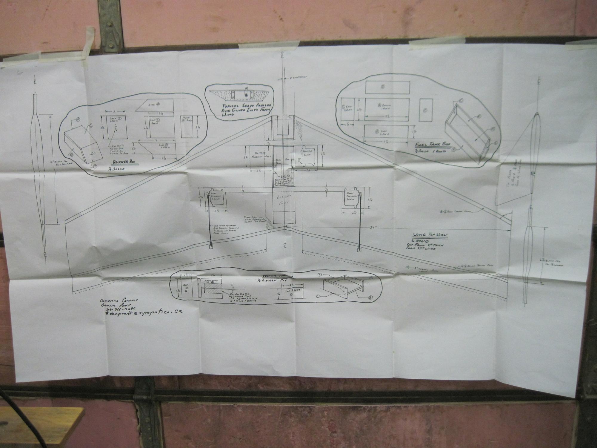

Found the prints they are old first generation I can describe the changes that were made that made it even better. What is it you wish to know Grasshopper?

Similar to a Stryker. They are pretty good. I remember seeing your other heavy lift plane go. 25 lbs. with a .61 was pretty good. It seemed like it would be impossible to even move it on the grass when I lifted it up, much less fly.

Thanks for the compliment on the heavy lift project it was fun, the plane weighed 7 lbs at 1000 square inches and it lifted 23.5 lbs for just over 30 lbs all up. Wish there was enough interest to do it again.
The flying wings that work well are all very similar. Optimizing the wing loading with control deflection to get maximum speed and maneuverability was the priority for this one. As a result the later improved versions had a combination motor mount/fuel tank assembly instead of separate. As the electronics and servos got smaller the doghouse on the back was dropped and everything was inside the wing cleaning it up considerable. The wing tip plates became smaller and most changed them to a profile that personalized them.
The biggest innovation was finding out that once built and flown you could remove the tip plates and shorten the wing up to 4 inches a side and just reapply the tip plates and fly without having to readjust for the CofG. The plane flew the same except the roll rate increased dramatically again increasing the maneuverability. We actually tried reducing the span even more but performance started to suffer so we settled on a 40 inch span down from 48.

How much for a copy of the plans?

As you noticed I live in Canada and the cost of copying is silly. I can walk you through it step by step with the improvements. Its really very simple. Do you have access to a foam cutter?
