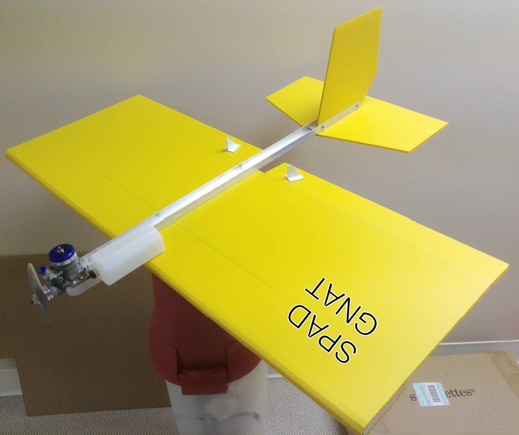

I got a question. I notice the above GNAT rules state fuselage length 24". The GNAT plans show the aluminum U channel as being 24" with the cutting board motor mount extending beyond the 24". I'm guessing it's not a big deal but I'd like to be clear on this.
Once while flying Indoor Free Flight at a contest, my "Easy Bee" was disqualified because my planes chord was 1/16" too long. Only because I followed the plan that came with my kit and through many copies had gained the extra dimension.
Maybe I'll never enter a combat session, but I'd like this plane to be RCCA GNAT legal. Line #2 in basics states, " Looks like a GNAT ". So maybe it's not such a big deal.

I think the intention is to build per the plan, which calls for a 24" piece of alum U channel.

My only comment is that we started with the cg at 4 and 1/4 inches back, and they flew, but like snot. We moved the CG forward and they flew better and better with each adjustment. I don't remember our final setting, but try it out if you are not happy with the flight characteristics.

Hmm, that makes sense. Might consider trying 3 3/4". Might be more to my liking, as far as flying. I do wonder what amount of throw up and down for the elevator and ailerons.

I would start with
1/2" up and down elevator
1/2"-3/4" up and down aileron
That said I have not built one of these yet, but that's about what I setup my other combat ships to.

The CG on the plan is wrong. It calls for 4 1/4"
It should be 3 3/4"..... Start there with control surface travel as Paul suggested then as you feel comfortable with the bird switch to high rates with all the control travel that it will throw.

Like Dane said,
U-channel 24 inches
Start with CG at 3 3/4" and what Paul said for throws. You should set up high rates for as much throw as you can get. The beauty of these planes is that they can slow furball, kind of a aerial ballet when you get a couple of good pilots 3-D'ing it out in the sky.

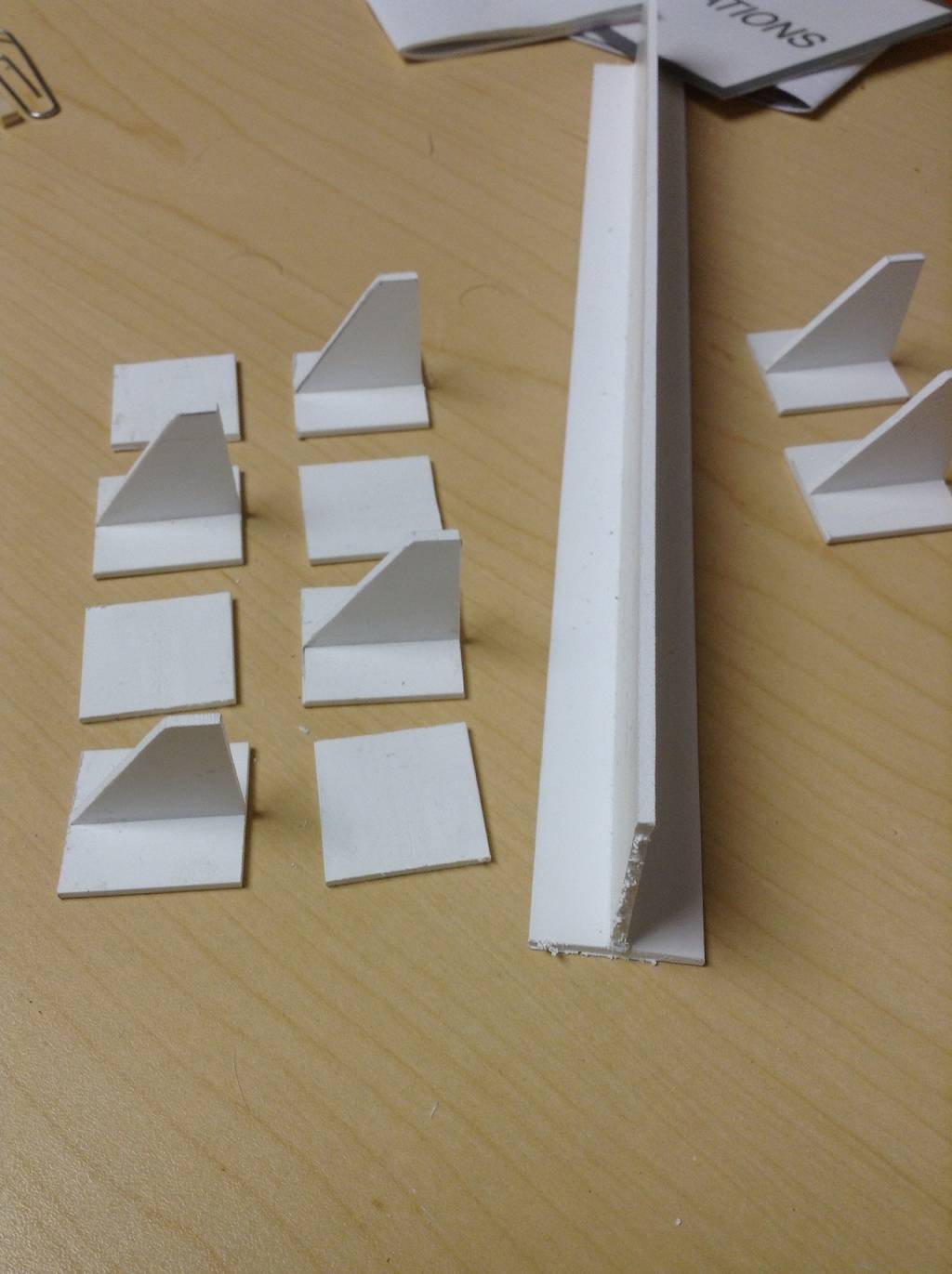

Found this drop ceiling molding that cuts real easy.

That stuff isn't too brittle compared to gutter pipe. It might be a little more brittle than fencepost but it it not warping like the post material. Thanks for the suggestion. I like the T shape compared to the L shape.

As far as I can tell, it appears to be PVC. I was specifically looking for a nice tight 90 degree strip. Found it at Lowes home improvement store. Came in a 8" length, I think.
It was marked on clearance (under $2), I should buy more.

Appears to be ACP White Ceiling Grid Component. Which is supposedly high quality PVC . I'm going to give it a try. Didn't mean to hijack this thread, but while looking for materials, I ran across this.
You can see how I was able to cut out two nice angle pieces for mounting vertical and horizontal stabilizer.
