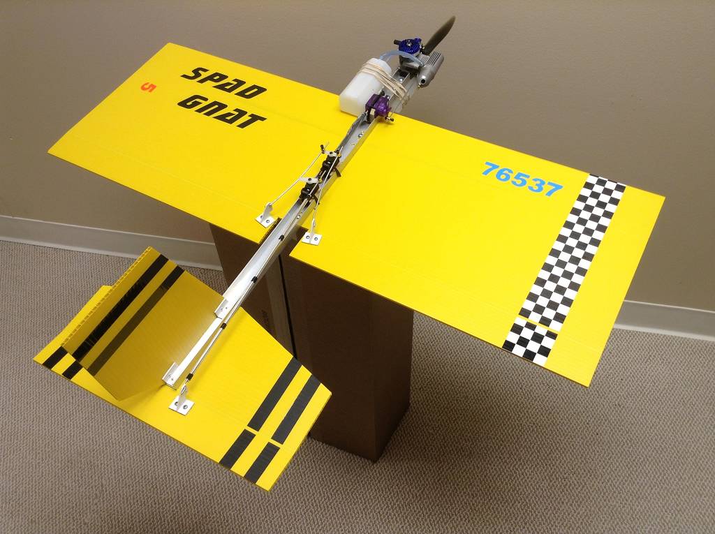

Set the throws and my Spad Gnat should be ready to fly.

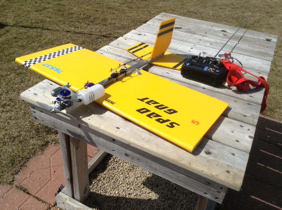

Wow, what a heart pounding wild ride for my maiden. Not sure if I was flying it or just avoiding the ground. So much fun I flew it a total of five times. What a fun little flier. Bank and crank, bank and crank. What a blast.
