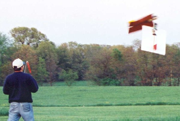

I love high speed combat......but lately we've been having a blast flying combat at near walking speeds with some Pizza Box Flyers. These extremely simple 25 powered coroplast flying wings have proven to be extremely rugged, extremely maneuverable, and extremely slow. Perfect for combat with or without streamers!
More info about these Pizza Box flyers is in the FUN FLY forum at the Pizza Box Flying thread.

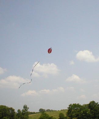

The flipppin Disk is on the same line as the PB, not real fast but effective and fun.

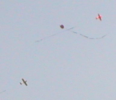

For this pic I was hovering giving everyone a chance to hit me, I was hoit finally , it tore the left wing along one of the flutes the entine span of the disk, tore one elevon almost off and disconnected the pushrod for the elevon. I was able to continue the flight and land with only one elevon , but I do have rudder control. What fun it is.
