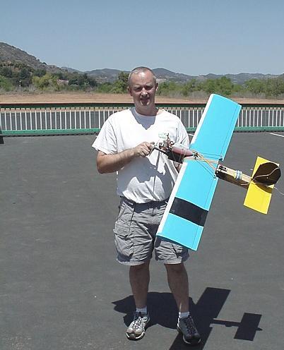

Default Check here, new glue for coro!
Check it out!
