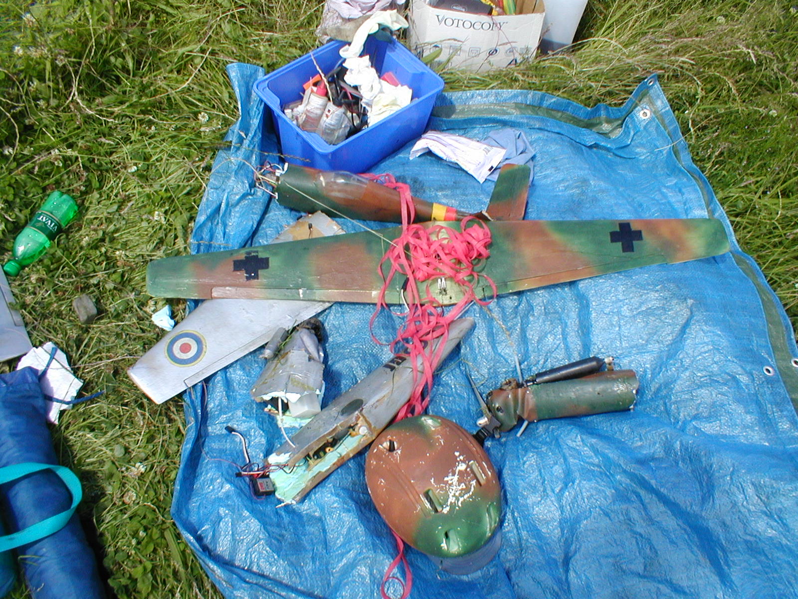

I built my 1/12th scale Spitefulls, Spitfire with a laminar flow P51 wing, from urethane foam and brownpaper applied with PVA glue. The cowlls were made by heat shrinking a plastic coke bottle over a balsa mold. They were surprisingly strong and very easy to repair even in the field.
The TA 152 has to have a glassed wing one ounce cloth onto bare foam. 1/2 oz is not strong enough [ ask me how I know ]
Rattle can silver and then some brushed on fuel proofer. Brushing nose to tail gives streaks that are very lifelike. Dave Platt taught me how to do this many many years ago.
The cost of each model was less than $10 without hardware. Would have been even less if I had gone scavenging foam off building sites. You are not likely to build for less.
SPADS are cheap but they do not fly anywhere near as well.
