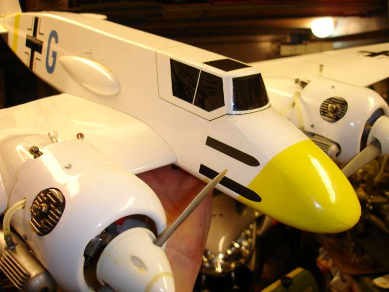

Hello!
Aircombat is very popular over here in Sweden. Flew it myself some years ago. See pictures of my own constructed German "Tank Buster" Henschel 129 A. Powered by two OS FP .10 engines driving 7x5 APC props. Span is 110cm and weight is 1360g.
Fueltanks are two Tettra "Bubbleless" 85cc (3,5oz) tanks.
I have plans available if anyone is interested.
Scale combat (with either .15 or .21 engines depending of full aircraft size is what is flown over here, no other class of combat).

Hi;Jaka:
Is that plane a foam type?You said you had the plans for it?Never worked with foam looks like some of the ones I see are cut out.Some communication with fellow from the ACES group I think they are Russian but there planes look to be fiberglass molded bodies with foam wings trying to get more info from the fellow,a benderfly I believe.Thanks Bob!

Hi!
No!
My HS 129 is made entirely of balsa (glass fiber nacelles and Coke plastic bottle cowls) coverd with oracover.
Most fliers over here in Sweden uses foam planes covered with brown paper or ordinary news papper.
