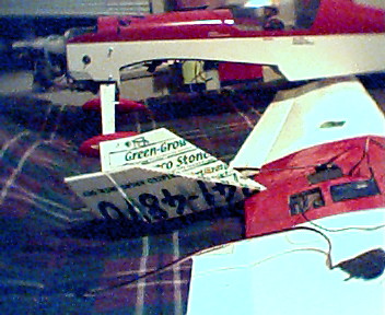

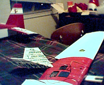

HI all
i was wondering if this type a plane needs a cg like a wing or normal plane
[img][/img]thank you hayk

You need to extend your elevons further to the center of the wing into the prop wash for more elevator authourity at launch. Cg needs to be 2.5" with 1/16th reflex and it will fly.

the plane has an elevator on the v tail i am not going to use the alerons like elevons, but i guess i can mix it in to the radio to have it on the swich, i just needed to know if this plane can be viwed as a normal plane or a wing?

...............that is a wing.
