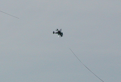

In September of 2002, I entered my first combat meet with a metallic silver JKAerotech P-47 Thunderbolt. In the fourth and final round, I mid-aired, head on at full throttle, with a dark blue JDBAerotec Bearcat. Picture is of the mid-air (Thanks Kirk!), and the second posting has the pic of the end result. If you look at the mid-air pic, you can see his engine and firewall above and to the left of the collision, as it separated from his plane and landed about 100 feet away! I suffered a broken prop and a stripped aileron servo. His plane was gutted. JKAerotech makes one tough plane!!

Good to see you on here. That was a heck of a mid-air, and I'm glad I managed to get that picture. It's been getting posted all over the place, actually, and it seems to be the current "best mid-air of the season" picture.

By the way, here are a few tips for the Thunderbolt, or any scale plane. Use metal geared servos...I stripped one plastic-gear servo during test flight crashes, and the other during that mid-air. Secondly, I don't follow the instructions as far as using a single aileron servo. I use one in each wing, laid flat in a cutout (see Corsair instructions on the JKAerotech home page). The reason is that if something goes wrong with this servo, you'll have to tear the plane apart to get to it (my wings are not removable). Also, I epoxied carbon fiber tape to the leading edges of my Thunderbolt and Corsair. If you look at the mid-air pic closely, you'll notice that the leading edge of my right wing panel sliced the other plane. Upon examination, I noticed a little damage to the leading edge of that wing on my plane (the carbon fiber/epoxy had cracked a little). Without the carbon fiber, that leading edge would have been crunched in quite a bit.
