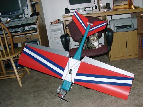

Default Latest combat plane
Trust me...go aileons and V-tail...!!!!!
Yep, Kraut's using a Norvel .25 and micro servos, and I'm using a Mag .28 and standard servos...both are Unlimited vertical to the moon! This plane rocks!
so does my cat "Spinner"
