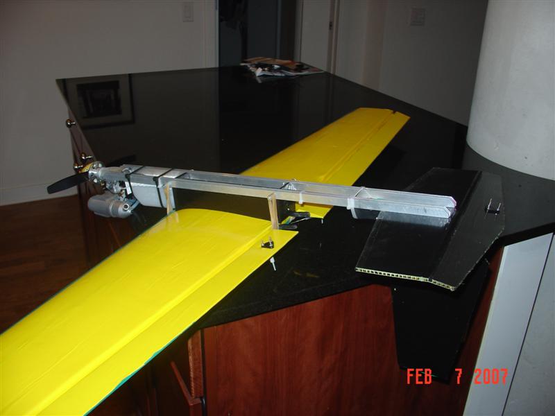

Thanks for the invite but that's quite a drive .. Come visit us here in Chicago too! The Battle Axe B is done, also known as "The Stalker."

Skukreja, Interesting to see how you did your wing dowels. I have found that any hole drilled in your fuse can come back to haunt you. I am new to the Battle axe but in my own design combat ships any place I drilled a hole became a weak spot.

oh yeah, I failed to mention that as a "mod." I used a very small screw with a big head, and then covered the exposed threads with some fuel tubing. I aluminum is extremely strong and I couldn't break it if I tried (and I did to a certain degree). If it takes a big enough hit to break the rails then either the wings would be trashed and the plane totalled, or new rails are something like $10-15. It's a cleaner design IMO than the dowel.
thanks for noticing,
sachin

Might as well pick up those rails now. If you do much combat that big hit is coming your way.
