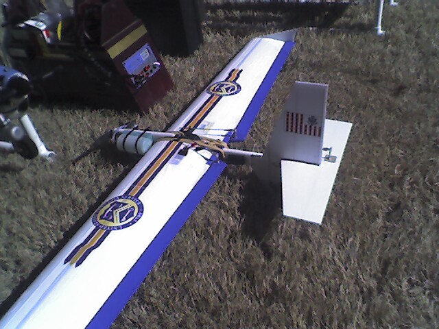

I am almost finished. I appreciate all the assistance. I think all I need to do is install the fuel tank. The pictures came out great. I printed them on some transparent sticky paper I bought at staples. I'll post some pictures later. Good thing I don't plan on doing combat with this beast it looks waaaaay too good!!!!!!

Finished the ripper. As promised here are some pics. Took it out this weekend. It was a little windy but it took right off. I am considering putting a .25 on it as it seems a little under powered. The wind threw it around a lot. Also, i think my CG is on the edge of being to far back so the elevator was very responsive. The flight ended in a flat spin to the ground with no damage other than a broken prop. That is why I purchased this plane, strong as steel and when I get the kinks knocked out I think it will be a lot of fun. Any advice on the CG, elevator throw, or engine would be greatly appreciated.
thanks,
Dan
