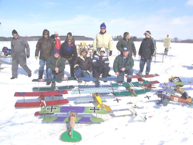

We flew WWI combat last Sunday at the Cobble Hills club near London, Ontario. 9 pilots showed up even though it was -10 celsius with a wicked 30 km/h wind. All the models are 1/8 scale and built primarily from coroplast and weigh between 4 and 5 lbs. Most have OS 25FX engines to help overcome the high wingloading so the speeds are faster than we'd like. Someday we'll switch to plain bearing engines and or small 4 strokes. Our designs have come a long way from a few years ago, when a successful take off was something to cheer about. Most rounds have a maximum of 5 in the air at once to reduce midairs. We're still experimenting with a forced circuit pattern and longer leaders on the 30 ft. streamers. One thing everyone agrees on...all those wings are a magnificent sight. Next contest is "Bloody April" in Toronto. Pic is from April 2005.

Hey Gary,
That's an impressive array of WW-1 models.
You guys are on the right track, There are lots of us who want to enjoy more relaxed flying and get nervous when people are zipping around like there hair is on fire.
I like the full fuselage models and hope someone starts to kit a few of these in 1/8 scale.
Keep up the good work and don't be afraid to post more pictures. Love those WW-1 planes.

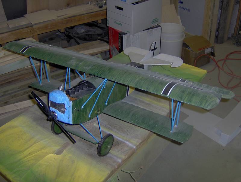

Well, as an experiment I built mine totally out of lite ply, foam board (The kind with paper on both sides that you can get from office depot) lite card board, and covered it in recycled paper, except the wings which are fabric covered. I'll have to post a pic if I can find one. Anyway, its cheap to build/repair and flys really well.ZZ.
[8D]This isn't the DVII I promised (gotta take some pics) but it is an earlier DVI built in a similar fashion. This one actually has paper covered lozenge wings printed from an inkjet printer.

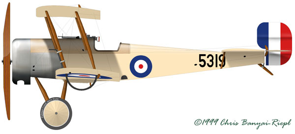

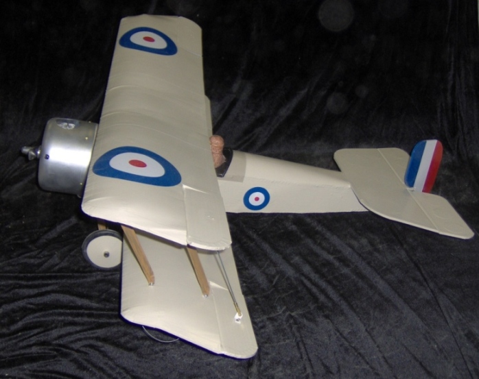

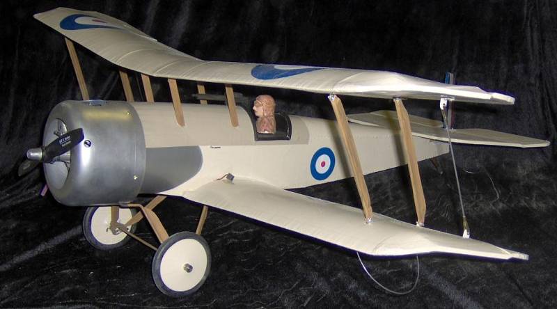

Heres my latest coro build designed for people who are new to building with coroplast for WW1
Its a Bristol Scout
scale 1/8
weight 3lbs 12oz
wing loading 16oz/sq.ft.
wingspan 37"
power OS .25fp
material 4mm coroplast, 2mm coroplast, foam turtle deck, sign vinyl covering
I'll let you know tomorrow how it flies.

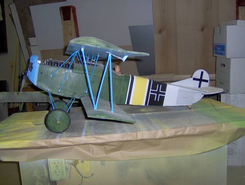

Here's a picture of my DVII which is a great flyer, except that I had engine troubles on the initial flight which I need to investigate further. It uses 2mm coroplat, 4 mm coroplat, foam turtle deck, foam leading edge, foam ribs, sign vinyl covering with latex house paint.
The design was loosely based on that MAN article, but I later exploded 3views and made it based on the 3 views, moving the wing position 2 inches aft for balance.
Its powered by an older OS .26 four stroke.
