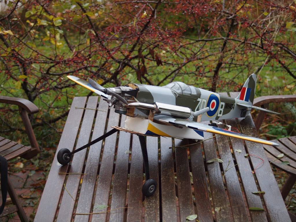

I must agree that the spitfire is the one of the funniest planes I ever owned in my life + its fairly cheep witch good for a student
. I’m on my second plane right now and I've just ordered the third because my current plane looks worn-out. She really looks like a warbird!
Im using Hs-81 for ailerons and hs 82mg for rudder and elevator, witch works very well.

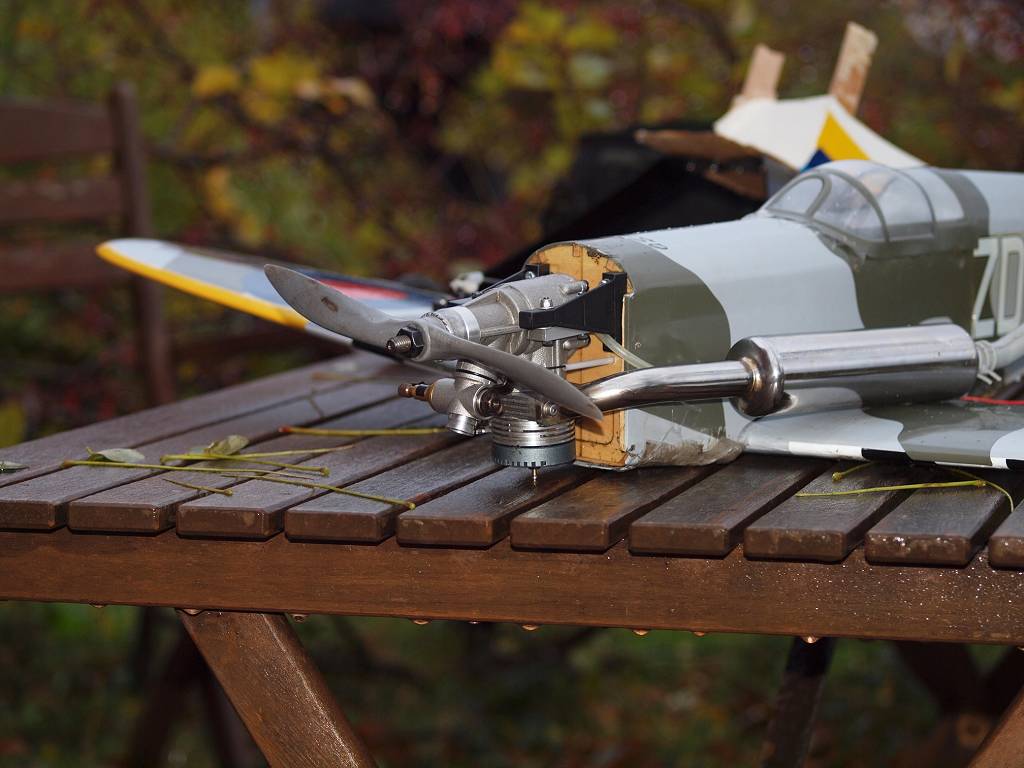

It was from its childhood powered by a OS 32sx but I've just mounted a Rossi 40 with a Stuker Jurgen muffler - I haven't tried it yet. Maybe it’s too heavy, but my experience says, that if the plane first is going then it's not a problem. The most critical is takeoff. I've made a simple trailer witch worked sometimes with the 32 Sx'er mounted, but it need some mortifications before i will try it out again.
I hope that you will understand my poor english
Here are some pictures of my model:

I'd love to see a movie of that trailer in action. And a movie of how fast it flies with that Rossi 40 with a Stuker Jurgen muffler!

Yep the trailer is pretty special. It's made out of my old Kyosho Osmose. Its to tall in the front so I think I'll need to shorten the landing gear up a bit. It is also too wide, witch effects the handling under takeoff. I will try to glue the sticks closer to the body and hopefully my handling will be better
The good thing about the trailer is that it's very cheap plus it was easy for me to build.
My goal is to beat a funjet, but i don't know if it's possible with this setup. The Rossi turns a 9x8 apc with about 15000 rpm and it's total weight with fuel will be between 1700-1900 grams (very heavy
