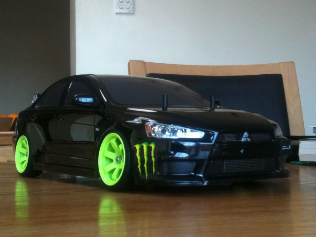

Hi guys,
I've gotten really into RC drifting over the past Year. I started with a Mitsubishi Evo X TT01E XB. I got full ball bearing set, allminum Shafts, camber adjustable arms and Oil shocks.
Very fun car. Reliable, easy to dismantle.
Now I've upped my game. I got a yokomo MR-4TC SD Genki Altezza. Very fun to build the kit. Lovely chassis. All you'd ever want, for a while
Anyway want to build a great car with great electronics. Not like the standard stuff in the TT01. I bought a Spektrum DX3C Transmitter and an SR3001 Pro reciever. And I have a Orion 4200mah SHO battery.
So all I need now is a good servo, motor and ESC. Any reccomendations. I'm just looking for a good quality motor to get me started, with good RPM. I want to be able to pull long drifts. Is brushless advisable. I would like my car setyp so that it wont need to be changed for a long while.
Thanks looking forward to hearing your choices, Daniel<br type="_moz" />
