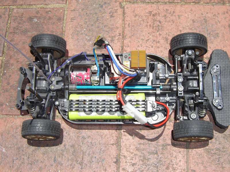

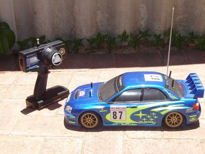

my tt-01, this it what they look like.

well i use mine for drifting with stock motor, and racing/bashing with a 9 turn motor. all stock gearing, does bout 55km/h

SenSei, you're running a 9 turn on stock gearing?!?! Why? You're gonna destroy that motor so quickly. And from what equipment you have on your car right now, you could've easily bought a much better car. TT-01's are great cars for budget minded beginners, but they'll end up making you want more.
pyrodon, if you can save up the money, skip the TT-01. Go for a TC3, TC4, Sprint, TB-01, TB-02, or TA-04.

i agree with u 100% man, i know that now, but i bought that car and had it stock for a while, but then i got the stuff to make it go fast, but now i realise i should have got a better chassis, and why will i destroy the motor ?

well i dont want to over gear my car, i have it geared for the most acceleration i can get at the moment (STOCK GEARING), i dont want to over heat my motor, and ESC. my motor gets so hot already i burnted my finger onit, and it gets so hot i can melt solder on it, and my hard wiring onto the ESC falls off when the solder melts [&:]

do you have a heat sink clip and a metal motor mount?, that might help alittle

your motor gets that hot because your on the Stock gearing.. and all that heat is what damages your motor, gear it properly and your heat issue will go away, beacuse only 55kmph with a 9 turn motor is not good... i get 60kmph my my 13x2 geared 19/87 in my Losi xxx-s. if you gear your car right you couild be going alot faster.
Gearing: you should drop a tooth on your pinion for every turn on your motor that you go down,i went from a 19t to a 13x2 so my gearing went from 25/97 to 19/87 hope this helps.
