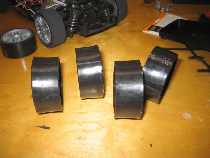

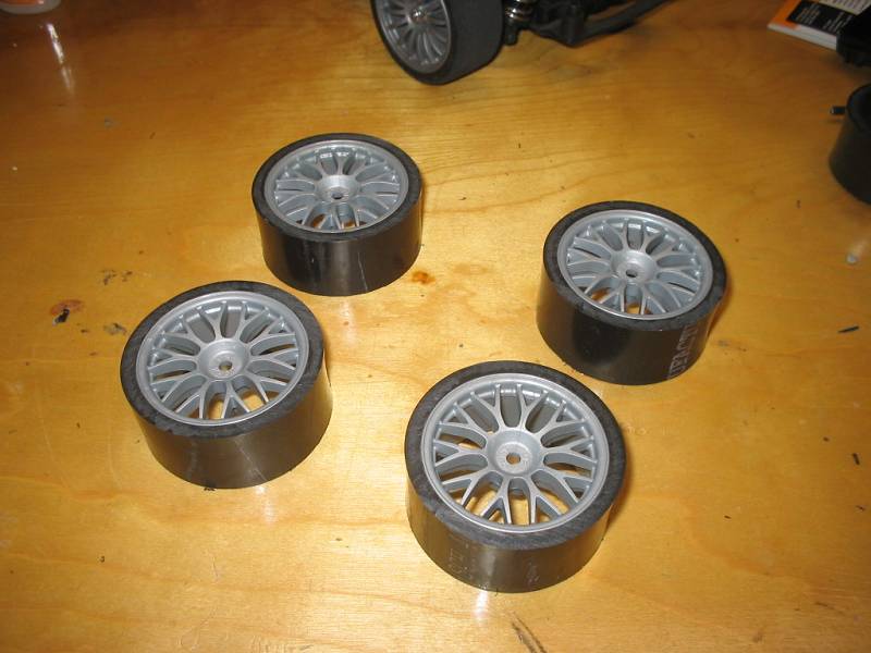

oh and for any other newbies out there, here's what happens when you bake your abs tires too long My 2nd attempt worked much better...

Why did you put the ABS in the oven in the first place?

the wheels were bigger than the abs. i put the tires in the oven for about 2-3 mins and they expanded just enough to slip in the rims. when they cooled, the wheels were secure in place. In my first attempt, i cooked them for about 5-8 mins and they melted all over the place.

400 degrees. i pulled them out 2 or 3 times every 60 seconds until i could push the wheels in.

Ill I usually have to do is freeze the wheels overnight and put the tires in hot tap water then throw them together with a rubber mallet, its a pretty safe and effective way of doing it.

Damn what kind of ABS are y'all getting? Mine are usually a hair bigger than my wheels, so I have to wrap the inside of the wheel with tape to get a snug fit.

I didn't want to wait They turned out better than i expected actually. They're very secure, w/no gaps between the wheel and abs. now.. does anyone have any advice about how to control my car

I get mine at any home improvement store, i.e. Home Depot, Ochard Supply Hardware, Lowe's, etc. Never had any fitment issues.
