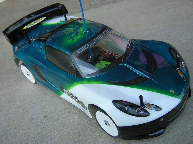

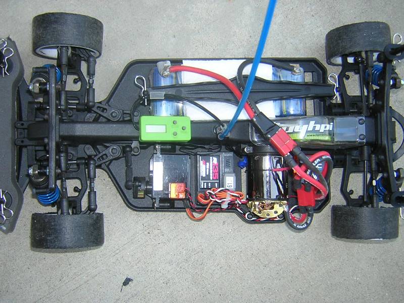

This is my first on-road 4WD car and I got it specifically for drifting. It's the xxx-s rtr2. I just thought I'd post my car, and let you know there is one more drifter out there.
When I first got it I: re-oiled my shocks with 32.5 weight, took the whole car apart to get familiar with the parts, oiled bearings, took the diffs apart (i didn't lock them, don't think I will need to).
I then put my JR xr3i radio in it. I put the xr2i into my mini-t. The xr2i has less set up features and is am. My mini-t will be good with it.

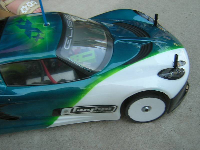

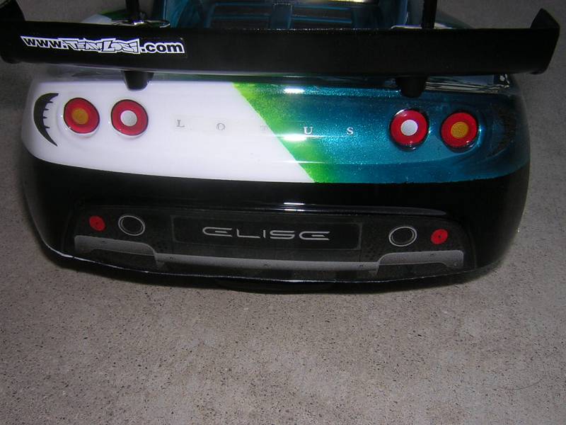

Got a Lotus Elise body from hpi, (see if you can point out the mess ups on the paint job, what I'm new to airbrushing, usually use spray cans).

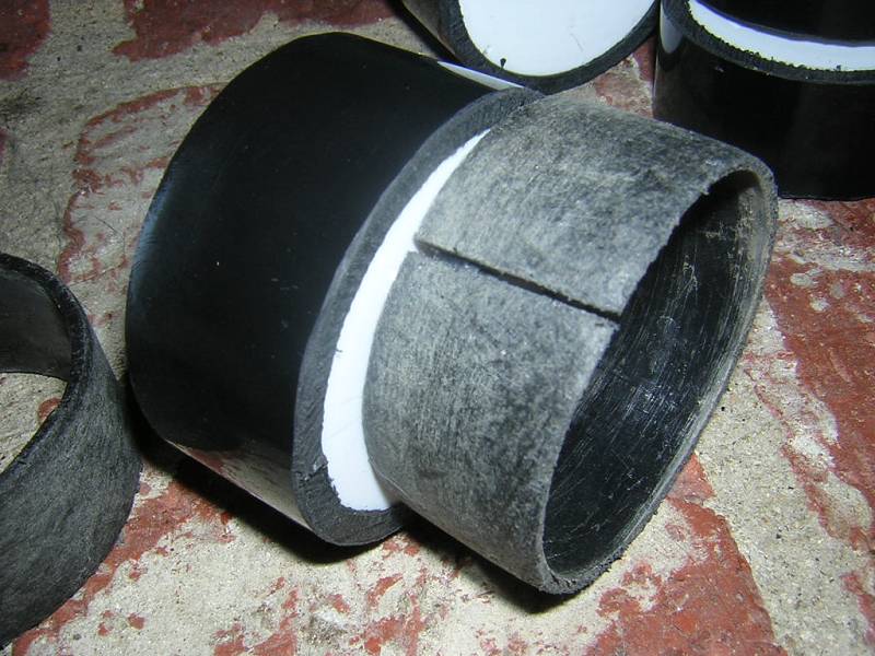

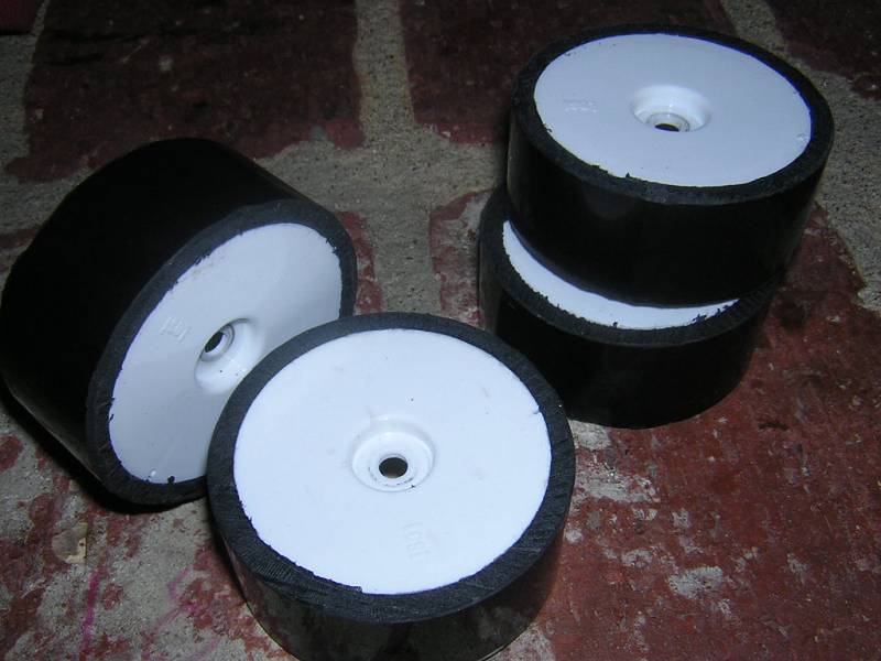

I went to home depot and got a big piece of abs pipe for drift tires. I will also try pvc pipe.

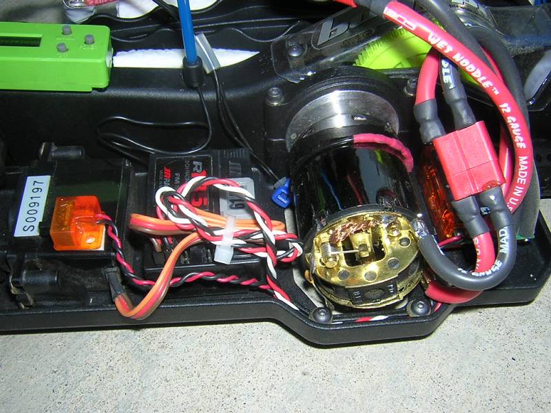

Then I was having trouble with the wires melting together. So I put 12 guage noodle wire on and deans connectors. FYI, it is very difficult to put 12 guage on that tiny esc.
I'm borrowing my dads temp. guage for now, it is getting up to 175 half way through a battery, so I ordered two Novak fans and a motor heat sink. Hopefully that will help. Another factor is that it's 106'F in Bakersfield on hot asphalt.[X(]
Well, I think thats about all I've done. I want to get the threaded shocks, but as you can see I'm completely out of money^^^^^^^^^^. Tell me what you think so far.[8D]

Love the paint and is it the motor getting that hot? If so try regearing.

That is one clean and well put together car.

Also how do you mount your drift tires? I used ac glue. It probably wasn't the best idea since I will have to change the tires every once in a while. They are down to the rims now and I am going to cut them off and redo them. I was thinking about useing silicone. What do you use?

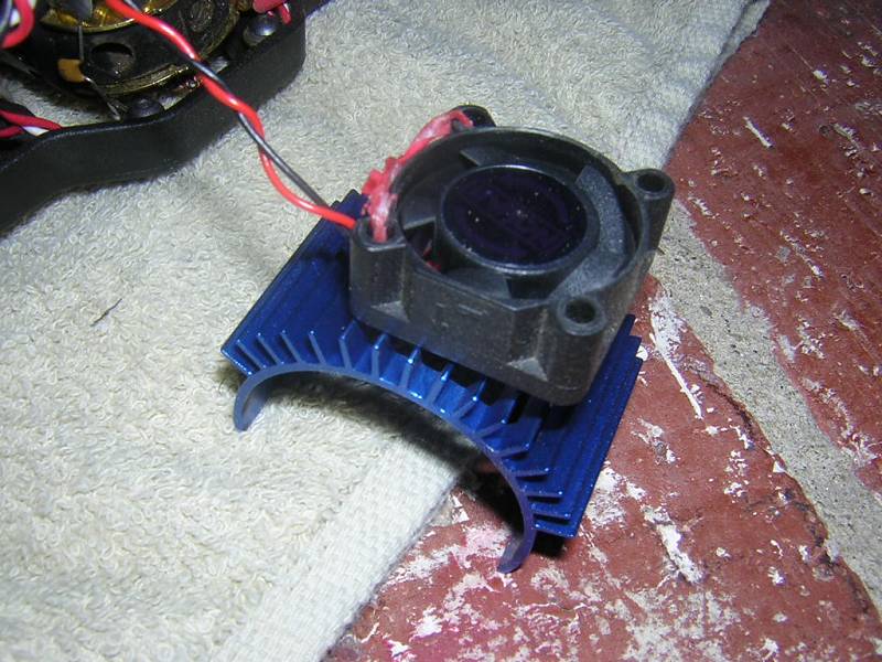

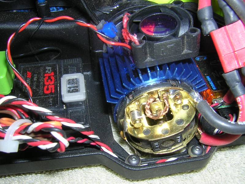

Well, I got the Integy heatsink and two novak fans on Friday and hooked them up this weekend. They seem to work fine plugged into the reciever (they didn't come with any directions).
I would say that it helps a lot. I can run a whole battery through it (ib3800), and if I take it easy it stays around 180' at the highest temp. Before I could only run half a battery and it would easily get that hot before I stopped. It once got to 200'.
It helps but I think 180' is still a bit hot. I would like to get it down to 140' at least. That sounds like a safe temp. Do you think I should gear it down? I don't want to get very technical about gearing, but if I experiment should I try gearing up or down from the stock gearing.

Here is my Integy heatsink and Novak fan.

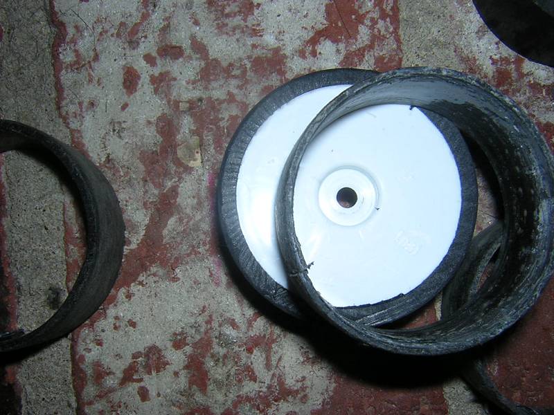

I also put new abs pipe on my rims last night. The ca glue actually worked very well. I just cut it in half and with a screwdriver I popped the rest of the pipe off. I only glued the insides of each tire. and I will try re-gearing today.

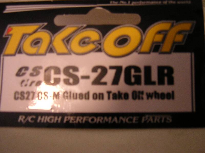

If you're looking for a good pair of street tires (not drifting), These things rule. This is the only tire allowed for racing at my track, so I got a pair. The hottest my motor got with these tires was 120', and it hauls butt and doesn't slide at all.
TakeOff
CS27 CS-M Glued on Take Off wheel

fow is abs a good street tire?

Sorry,
The tire in Italics isn't the abs pipe. It's a rubber slick tire, I just gave you the info on it in case you wanted a good street tire.

Nice man. That Lotus body looks pretty clean. I like how you got the "XXX" on the top.

The Lotus body has a lot of down force. I was a little surprised. Once you get it going pretty fast with drift tires (abs pipe) it sticks to the street very well. I can make small steering adjustments as I'm going down the street and it wont spin out. The tires are being pushed down so much that it is like driving on sand paper. And then of coarse, I turn it sideways and slide about 50 more feet.[X(]
I have not tried it with my high grip tires but I will do that when drifting stops being so fun, lol. I have to put the stock body on though. I had a little trouble mounting this body because it was not made for it. I have a Shelby Mustang body that is waiting to be mounted and painted when I get a chance.
