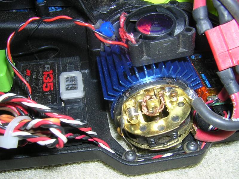

My Team Losi xxx-s had an overheating problem when I first started drifting.
First off, make sure nothing is binding. I got a heat sink from Integy and mounted a Novak fan to it with a bread twisty. You can plug it into an extra spot on your reciever and it will turn on when you turn the car on. At first my car got to 200'+, now the highest it will go is 155' during the summer. Now that it is winter, I have run it a few times lately and it has only gone up to 135'.
btw, I am running a 19t Komodo Dragon which has bearings and probably helps with the heat also. Here are pics of the heat sink and fan.
good luck

Drifting requires lots of torque and rarely off throttle. A smaller pinion gear is suggested. Still remember last time I drift with my Tamiya TA03F with sport tuned motor, I had the solder melted at night time temperature. Imagine how hot it got.

I'd change the gearing before getting a heatsink. The heatsink will only reduce temps, but won't do anything for the longevity of your equipment. When properly geared, your equipment will run cooler. Simply adding a heatsink only masks the problem.

Yes, gearing can be a problem. Find the stock gearing and drop the pinion 2-3 teeth. All you need is torque.
However the heatsink and fan are really a great investment and they do work. Dropping the temp. by 40-50 degrees is amazing. I can go "all out" with mine and when I stop and pick it up you can watch the temp fall. If you think about it, the motor is inside of the car and you're drifting so you don't get much air-flow. Also, on a sedan, the motor is very close to the asphalt, which is hot. It just needs extra help cooling.
