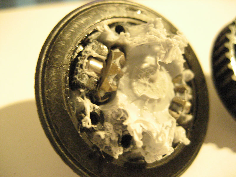

I have added Blue Tac in my Hyper 10 rear diff, opened it up and did notice that the blue tac after 2 meetings at local hobbie track it did soften up! However it worked great, got much better power out of the rear wheels on my Nitro RC!!!
I have repacked the diff again with new Blue Tac, and cleaned all the grease i had in it before, ill see how i go next round and shall post some pics to see how its done....! I guess its a cheap way out of it - note no damage was found YET
cheers
MADCAP
Old 12-20-2006 | 10:25 PM
Joined: Dec 2006
Posts: 5
From: Adeliade, AUSTRALIA
Default RE: locking rs4 rear diff
Ok last night at the Drift Practice, we had Blue Tac in our cars once again! Was awesome for half the night, then noticed the rear getting how can i say open wheel as the blue tac did soften up a tab, thou still drifted better than some lame grease inside!!!
No signs of damage after 2 hours of pure thrashing!
Next will to put some adhesive, like NEED IT clay to harden it all inside so there is no moment inside the spider gears... besides that i finally after 3 weeks linked the track completly once, the next step is to get a balance of consitancy to do it over and over again!
Enjoy
Old 12-22-2006 | 06:25 AM
Joined: Dec 2006
Posts: 5
Here are some pictures of the diff, after a 2hour drift session - note you can see how the gears still spin over time with blue tac inside, sure it looks messy, but next thing is to i guess fully glue it with some clay mould so that there is no movement inside!!!
