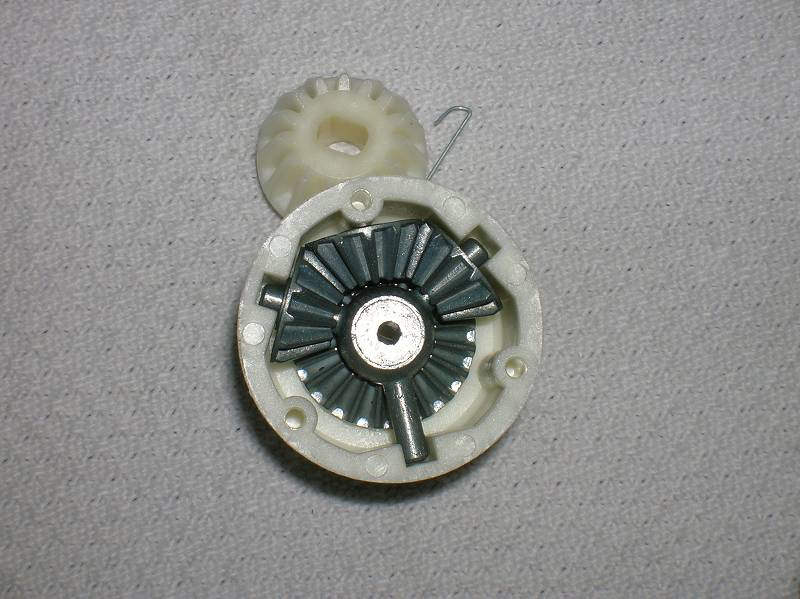

here is another way to fully lock the diff. and u can remove it to make it normal when needed. there are 3 spider gears. what u do is put the gear between the other 2 for a locked diff. hope the pics help. i learned this trick building my TLT rock crawler! i dont know if this has been posted or not but here u go anyways. thanks

does this trick allow any play, or is it just like using JBweld, wouldnt this put more stress on the drive train then say using playdo or something

hmm. i see ur testing to see if i was right or not. lol. well i think this might allow a little of play it seems to be a non messy way and good way to lock ur diff. ill be trying this later tomorow

haha not testing you just using what i learned yeah this does seem like a great and easy way to lock the dif, just hope it gives a lil play like we talked about online

i use blue tack or putty, in one of my tt-01's i even put eleastic bands in the diffs, gave it play but the more i drifted the tighter it was and helped maintaine the longer slides!!...

the drivetrain will handle it. if my TLT rock crawler can survive with this setup then it will for the TT01. thanks

Sticking to blu-tac... its easier and proven method in drifting..
Blu tac allows movement Essentially turning the diff into a limited slip which is desired any way..

my locked diff setup works good. but u can try that blue tac way. ull experiance a limited slip effect like a real car which works well also.

hmm intresting, might try it. right now my gear diff is locked up via ducttape strips. you pack a whole bunch in there and it works like an limited slip
