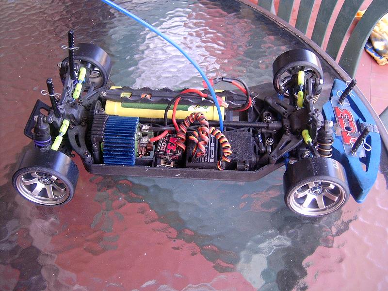

I also have a TC3 and I am running it with the front diff locked and the rear one with thick grease and a bit tight. Here is a link on how to lock a ball diff.
http://www.sflrcdrift.com/driftitems/
and go to how to lock diffs
and here are some pics of my TC3
ID:	767580   Click image for larger version
