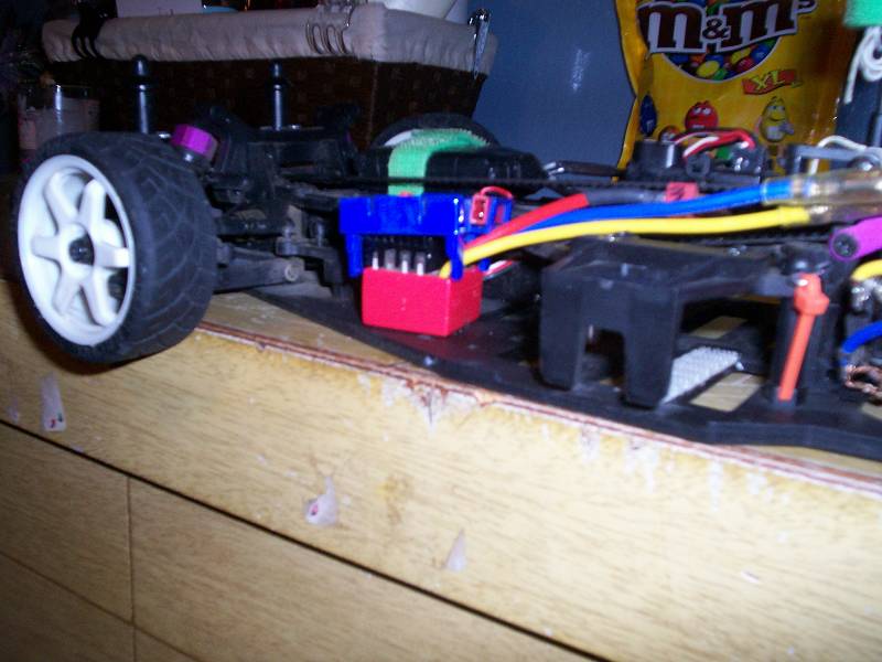

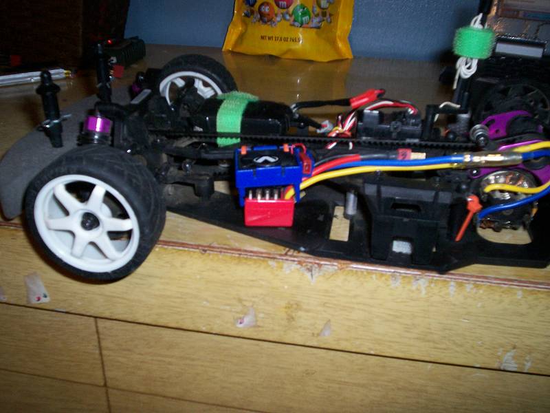

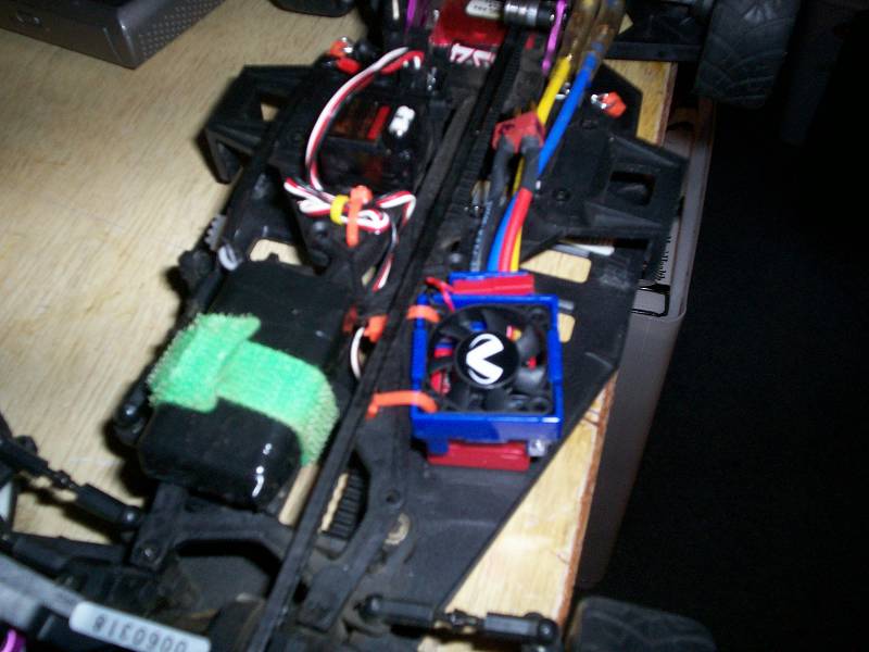

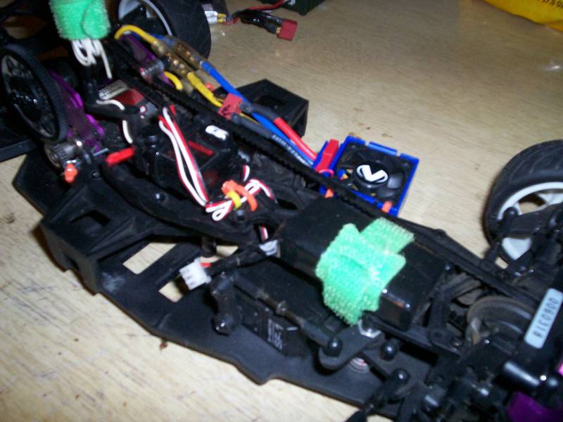

Check out my Fan install. Let me know what you think. Works great and keeps temps way down. Powered by a small 900mah 2S 15C Lipo.

Old 04-12-2009 | 05:34 PM
Joined: Feb 2007
Posts: 2,071
From: , AUSTRALIA
Default RE: HPI Sprint 2 drift Setup????
I am not a fan of Lipo when drifting.. I prefer the weight of a Nimh Battery... Gives the chassis more weight resulting in a tail thats easier to kick out...
I do Hope you are using a Lipo cut off with that ESC as I would hate to see what happens if the Voltage drops too low....

There is next to no drain on the fan lipo. With that 900mah fully dead it usually takes a good hour to charge. After having that fan on for 15-20 minutes, it only took 4 minutes to top if off. Rather nice if you ask me. But I think my temp problem is because the pinion is too big. I just counted it and it's a 28T pinion. I wanna drop to a 19-21T.
