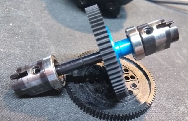

ANYWAYS I didn't like the spur holder on the E-MT I made and found the TT-02 spur holder by accident last week on amazon while looking for something else.
So I slid that on the MT spur's shaft, and saw how well it so I cut the blue aluminum collar a little so it holds it tight against the drive pin.

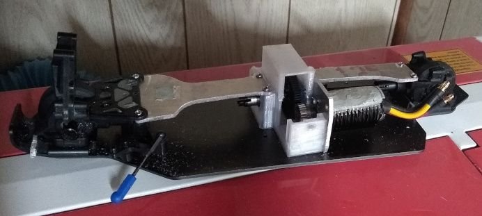

but due to pushing the bearings to the drive cups I had to redesign the center gearbox from the e-mt build (note this is another MT chassis the e-mt I made is not being used), and made a few other changes to fix things I didn't care for. I cut a copy of the E-mt's braces out of some 3mm aluminum from a project I scrapped decades ago with a motor mount and am at this point in the build
A little bit different design as in the e-mt the motor plate moved this time I'm just moving the motor so I cut out the front to allow access.
The pinion cover is being made as I type this. (the housing is made of petg for temp resilience)

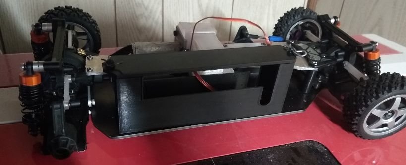

pic time.
I found all the dogbones I needed in my bag of dog bones... but to make them work I had to make the arms 2.5mms longer in the front, and 6.5 in the back(this is due to the axles I'm using in the back).
So the work on the jig was a waste.
Anyways here is the pics so far.
The Front
The back
As can see the one side is missing an axle that is cause I could only find 1. I'm waiting for a pair I ordered expected to come sometime later this week.

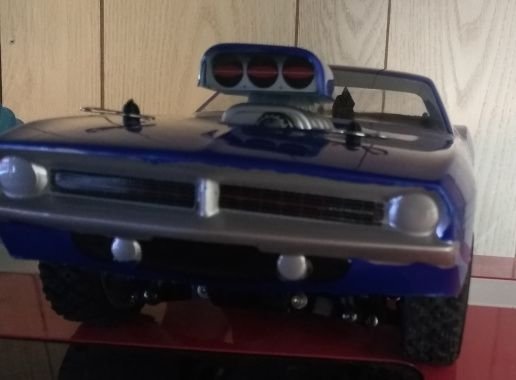

Here is how the body looks sitting on it I still need to figure out body mounts setup
As can be seen from the side front to back it is PERFECT for spacing
Width wise it sticks out a TINY bit, but alas it was that or I try to custom make dog bones, and hope they hold up.
Well with what I had to do the rear sticks out maybe 5mm's more then the front, but it isn't noticeable as the body flares in the back, and it was unavoidable.

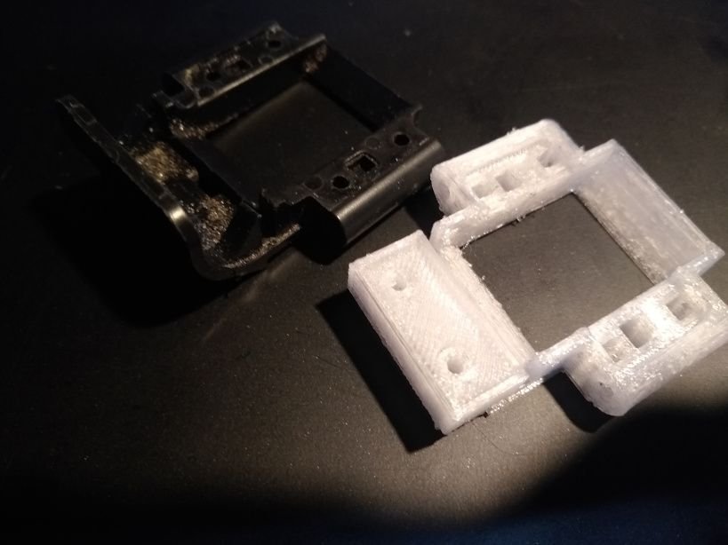

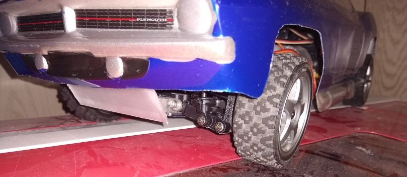

Well... I remade the front somewhat
Designed a new piece that the arms mount to so I could also add a bumper. This is the 3rd iteration. In the 1st the bumper was part of the mount, but I decided it would be best to have it screw on as I can also change the bumper design easier, and not have to take the entire RC apart to switch it out..
Old vs the new.
One minor caveat that is not a picture of the final version that is on the vehicle the one in the picture had a slight issue that honestly even side by side you couldn't tell the difference in so I used it for the picture as I had the final version on the RC by the time I thought about doing a comparison image. Just to say how close they were I mixed them up when I was going to change them, and had to break out the calipers to measure the section I enlarged to see which was .5mm's larger to figure it out, and yes that .5mm's made a big difference in how the axle housing was seated.
here is it installed with the bumper/ front skid plate or whatever you want to call it.
I made it in petg so it has a LOT of flex, and will absorb quite a bit of energy if it takes a hit. If you push it from the top you can move it over an inch back, and it will spring back like it was never bent..
