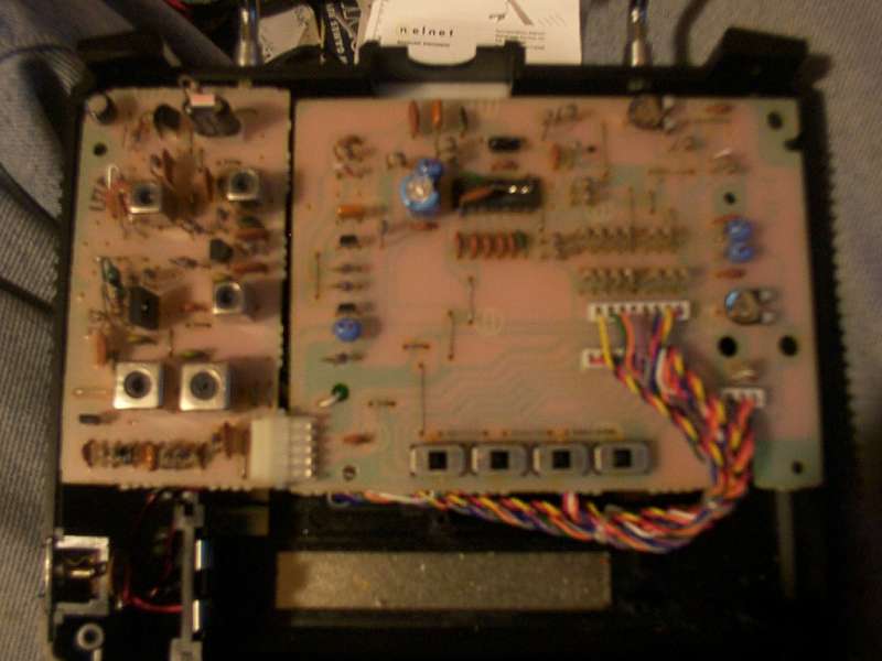

ps-Eric, or anyone, any thoughts on that non-buddy cord output?? Here's what the inside of my Tx looks like-I just need to know where to jump output signal from[sm=confused.gif]

Find the trainer switch on top of the radio and look on the inside to verify that it is a three-pole switch (probably spring loaded one way). With the trainer switch in its normal position, the PWM signal comes in on one side and goes back out to the RF deck through the center pole. With the trainer switch pulled the other way, the PWm signal comes in from the other radio on the other side of the three-pole switch and goes back out to the RF deck on the center wire. You need to pull the PWM signal from the center pole and feed that to FMS through the parallel or serial interface you build.
An example is on my web page at:
http://members.fortunecity.com/chris...fwiw/fwiw.html
Chris

That would be great if I had a Switch on my Tx.....but alas it is not so. Thats what I'm stumped on where 2 find signal. I guess I'll just go over it point by point with my multi untill I find my signal v....I think around 4.6v.
Good link though Chris.....thanx.

I took another look at the picture you posted. Your RF deck is the smaller board on the left. The PWM signal should be one of the 5 wires coming over from the main board on that 5-pin connector on the bottom. Follow the trace from those 5 conectors back to ground/power/IC's ... One of them should be the signal. If you have access to an oscilliscope, you should be able to pick it out easily.
Chris

I was kinda guessin' the same as my crystal is in the smaller board,and I see exactly what u mean about the jumped section. ...and I'm in the process of hunting an oscilloscope program on-line. Many thanks for the conformation.
Also...why do you use the transistor in this model and not the diode I've seen in others?
Brian
