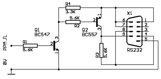

thanks a again for the info. I found this schematic at the FMS web site don't know if it will work or not. Take a look would you. Thanks

yeah, that's teh basic one,
but it'll probably give you trouble (or won't work at all) if you're running win XP or win2k
you'll need a machine with win 98
