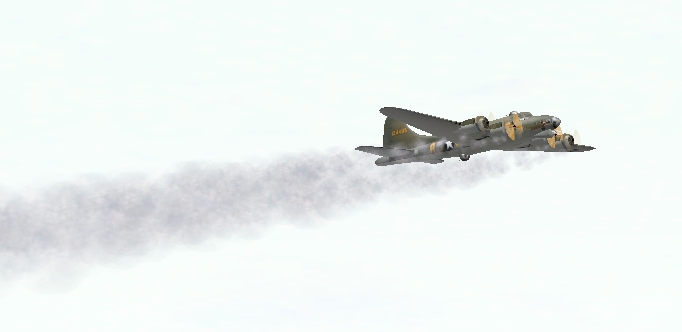

I'm having trouble getting smoke to work on some of the models, i.e. the F-16. Anybody got a step by step foolproof way to set up smoke on any airplane? I'd like it to work via the 3-position switch.

If smoke is not an option on the original plane, you can make a copy. Edit the copy and go into misc tab, click the box that say radio controls smoke, go back to the servos tab and pick a switch to use it on. It will work with combustable engines and ducted fan but not turbne. Here is a Large b-17 blowin smoke and an a-10 with a DF smokin up the place. Hope that helps,
Warren

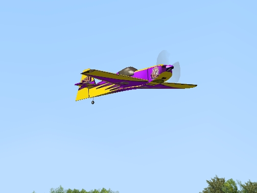

LOL, You can also set up a cap with retracts. Pretty funny
Warren
