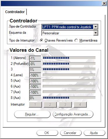

I did some tests.. FMS can handle the signals very well but I cannot say the same with Real Flight G2. G2 doesn not detect the signal of the acelerator. This is the only problem I got. Did anybody try to use this kind o cable with G2 ? Will it work or G2 is more exigent than FMS ?
Thanks to everybody for replying my questions..
Ps.: Take a look on the attached picture. The channel 3 has no description.
Regards
Christian

One thing you can try, is to assign the throttle to analog channel 5 in the PPJoy setup. I remember something about this when I was playing around with the PPJoy software. I am not 100% sure, but I think this problem was only present when using Win98.
