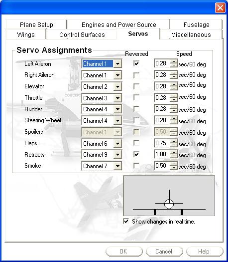

i see that the new controler has a smoke toggle on the right. i just plugged mine in and starting playing, anyway how does that smoke button work (does it require set up) as i usually just turn it on on the on screen menu. So will i be able to cut it off and on from the controller?

Mayur,
Check this out go to the P-51 plane its set up with more channels, anyway change your setting to read like the pic i included the main thing is change smoke to read channel 7. With this you can now use smoke on that plane. Now that 330 is another deal i am working on. Let me know if this part works for you.

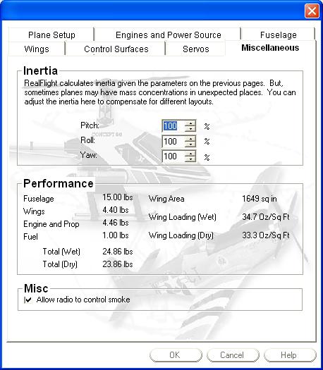

Okay i have it go to the edit menu under planes make sure you have a plane renamed for this use.
then go under miscellaneous:
then look at the bottom of the page wow it says let the radio control smoke of course click on that. make sure under the servo menu you have smoke controlled on channel 7. Wow we are smoking now TME pump and all.
I hear that it makes a mess to clean up on the plane well i am getting ready to find out.............

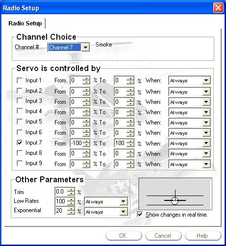

make sure under edit radio type software radio is checked then also go to edit Now!
make sure under channel 7 your numbers read -100 to 100 on channel 7 when you stroll down to that part i have included a pic i have all my plane able to smoke from a click of a toggle now.
