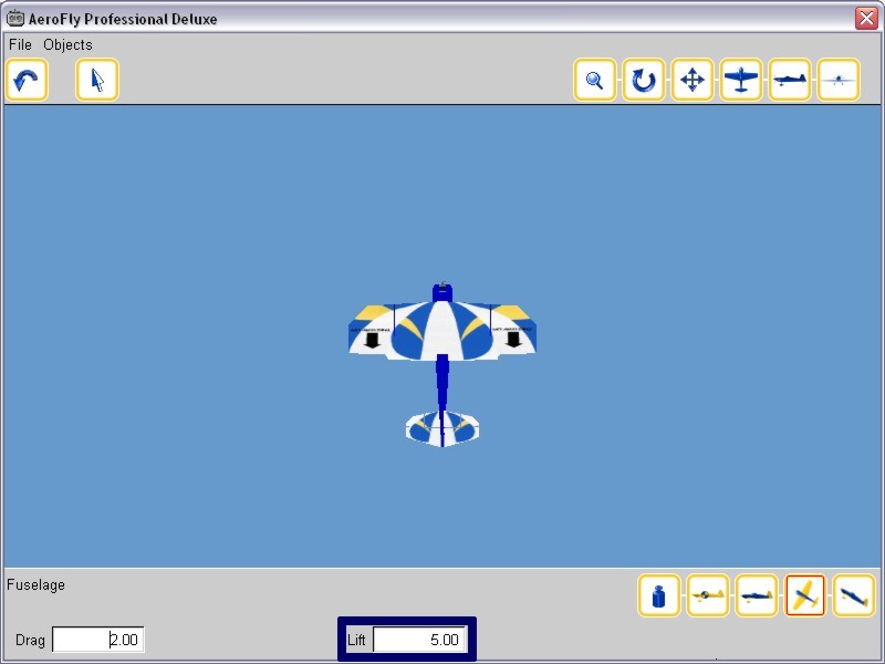

Well you can add side lift to the parameters ... did you know that?

Default RE: E-Flite Tensor for AFPD
See attached!
You can adjust it to whatever you want in the TMD file!
Greg.

i know you can adjust it, but i dont know the code in the TMD. What is it??
Ian

cd Fuselage/
X = tmvector4r( 1.0000, 0.0000, 0.0000, 0 )
Y = tmvector4r( 0.0000, 1.0000, 0.0000, 0 )
Z = tmvector4r( 0.0000, 0.0000, 1.0000, 0 )
R = tmvector4r( -0.0119, 0.0008, 0.0633, 1 )
Geometry( "~Geometry/Fuselage/" )
Mass = 0.04536
RangeMassMax = 0.5
RangeMassMin = 0.025
Inertia = { 0.0006, 0.0000, 0.0000, 0.0000, 0.0000, 0.0005, -0.0000, 0.0000, 0.0000, -0.0000, 0.0007, 0.0000, 0.0000, 0.0000, 0.0000, 214.0990 }
Kn = 1000
Dn = 20
Dv = 0.05
AreaCenter = tmvector4r( 0.0000, 0.0000, 0.0000, 1 )
CG = tmvector4r( 0.0210, 0.0000, 0.0130, 1 )
SmokeR = tmvector4r( 0.0000, 0.0000, 0.0000, 1 )
Cdx = 2
Cly = 5<<<<<<<<<<<<&l t;<<<<<<
Cdy = 2
Clz = 0.5
Cdz = 2
InertiaScale = 0
cd ../
NP
Greg.

riiiiiight! ill give it a try!...............trying............yay got it!

ive had a try with lots of differet setting and ive found that there is a side effect of increasing KE lift that the rudder becomes less and less efective untill the point where at 100 on the lift the rudder, even at 60 degrees and 100 propwash its totally useless. ive found 5 KE lift and 60 degrees rudder + 100 propwash is a good balance
Ian
