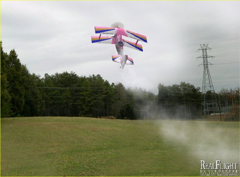

Time to celebrate! My first usable but not perfect Photofield! Thanks to all that helped! Now for some 3D in the Backyard Photofield!
