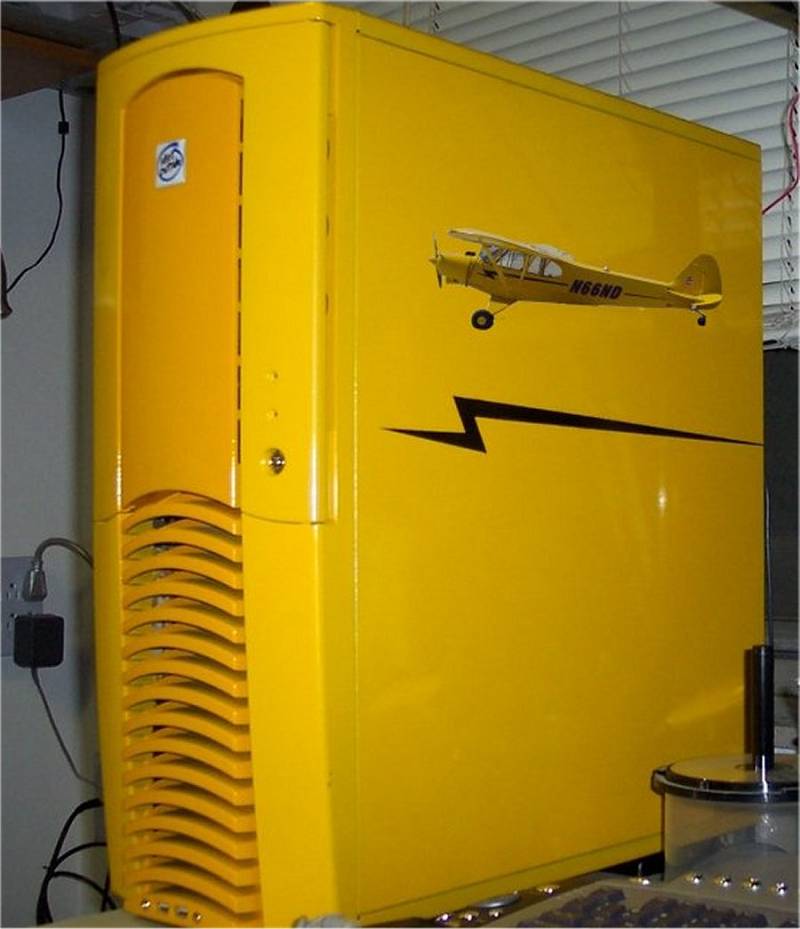

I build and repair PCs for a living specializing in affordable custom gaming and flight sim machines like the one below I did for a J3Cub pilot here in RCU.
I guess I need to upgrade for myself soon with the new sims coming . LOL
If I can ever help any of you with a build or problem please let me know.
